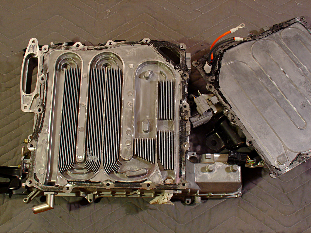

  17. JimboPalmer
    Apr 14, 2009
    12,470
    6,878
    Greenwood MS USA

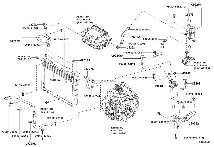

    Both the engine and the inverter are cooled by Toyota Long Life Coolant. (or equivalent)
    They are separate systems, with their own pumps, reservoirs, etc. The Inverter runs cooler than the engine. (that system also cools the transaxle)
    Here is a picture of the coolant channels in the inverter: (there are more fins where there is the most heat, this is a Gen 2)
    The hoses that make the system in my Prius v.
    As you can see, in the v, the top of the radiator is for the inverter. I think it is the bottom in Gen 2.
