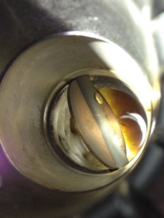

    Believe it or not, I'm still working on this. I've confirmed the ABS isn't working, the brakes have locked up a couple times on very hard stops. I resurfaced the rotors (seems like they need it every spring) and all the shuddering and noise is gone when braking.
    The car is losing oil and has P0420 (cat converter - probably fouled O2 sensors from burning oil). I'm focused on finding out where the oil is going. I found a puddle in the intake manifold, but everybody says that's normal for a Prius.
    It also had a bout of 'big hand syndrome' recently. I think I cleared that up (all hail bwilson).
