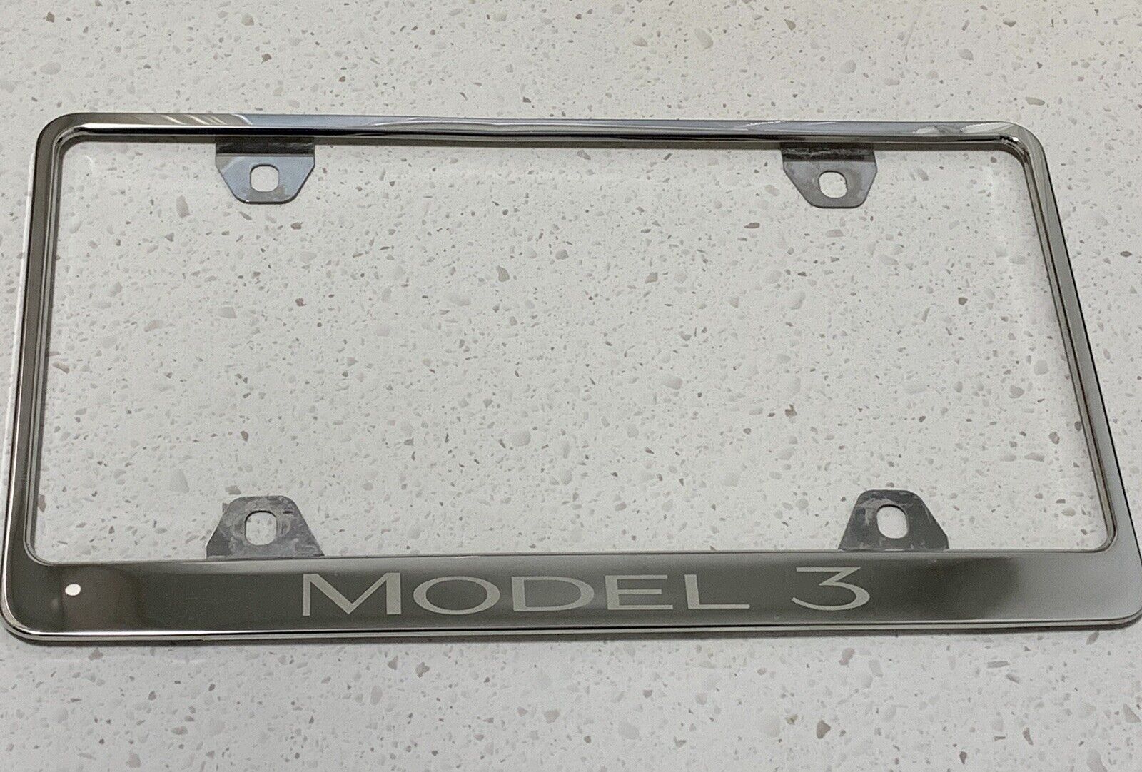

    I've grown fond of license plate "vaults" (acrylic face and gasket seal) such as the WeatherTech units that protect the plates while being sufficiently svelte so as to not obstruct the state or veteran info:

    Nice, but how does the plate stay on if the frame doesn’t cover any part of it?

    The screws that go through the plate's holes into the mounting bracket of the car.
    Likely abandoned because it wouldn't work in markets with differing size plates, and a possibility of blocking something if a state made a change to their plate, but still the best plate mount was on my first car; a 1986 Buick Park Avenue. For the rear, you just opened the trunk, and dropped the plate into a slot.
