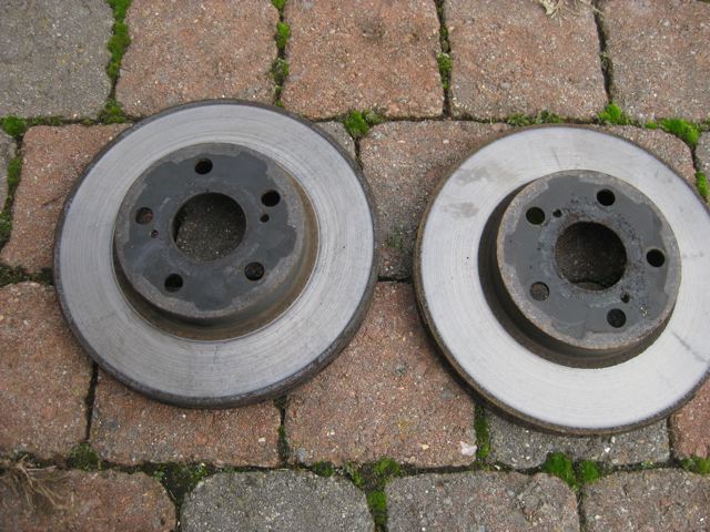

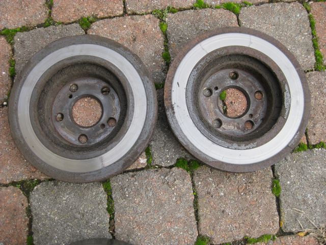

    Rust does impact on how efficient your brakes are. When the rotors get very rusty the rust is more abrasive than the non rusted cleaner areas of the rotors. The rust wares the pads away reducing the area of working pad. Often the rears of the rotors "the area you cannot" see is much rustier than the area you can see.

    Pictures of front brake rotors off the Prius. Note how the visable surface compares with the hidden surface that probably has only 50% of it's area working.[​IMG]
