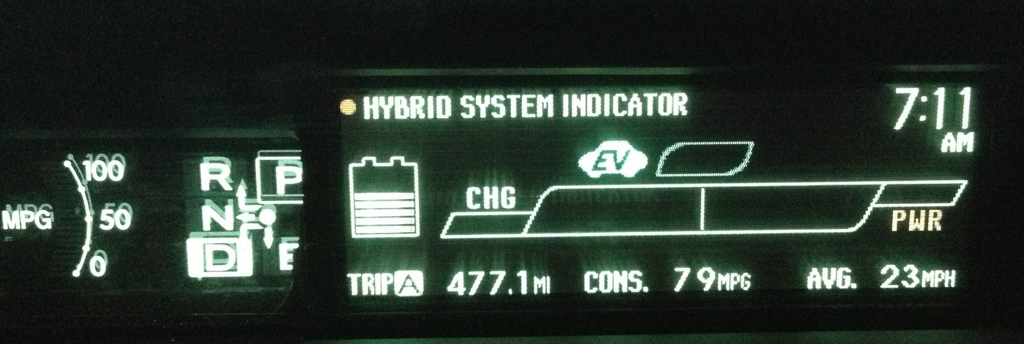

    To maximize mileage, it helps to use the Hybrid System Display:
    If you're applying gas and the MPG gauge indicates 100 MPG, it means the gas engine (ICE) is off.
    If you're braking, look at the left edge of the Hybrid System Display (HSD), if its safe to do so. If you're coasting or gently braking, this indicator fills to show you how much regenerative braking (battery recharging) is occurring. If it fills completely, though, then the friction brakes are being applied, which you should avoid unless necessary.
    When you accelerate in HV mode, the left half of the HSI will fill to indicate that you're accelerating under battery power. If you accelerate a little harder, the HSI will pass the center line and the ICE will start. If the ICE starts and you accelerate within the large, left-side "ECO" zone of the HSI, you're maximizing efficiency. If you accelerate and the right-most PWR edge of the HSI illuminates, then you aren't maximizing economy and if you drive around all the time like this please don't complain about your terrible gas mileage.
    G. G. likes this.
