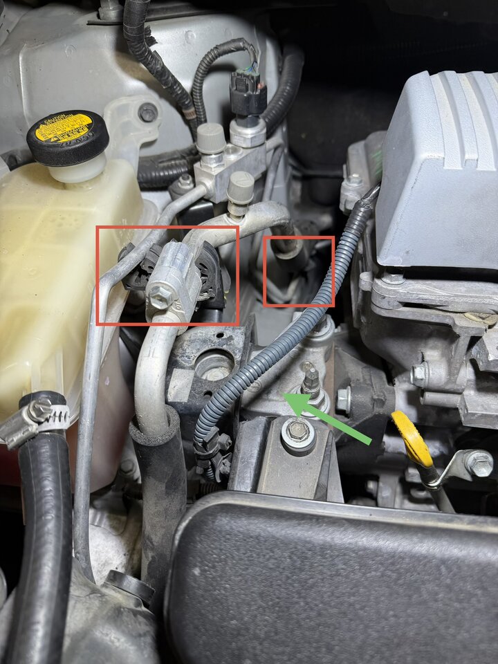

    Discharge line from compressor to condenser has a flexible hose portion.
    The smaller diameter line below is the high pressure liquid line after the condenser and the larger is the suction line. Both are secured as shown within the red boxes. The green arrow is the most likely motor mount.

    Those pictures look nothing like my setup. It is my understanding and also the understanding of RockAuto that this is the discharge line

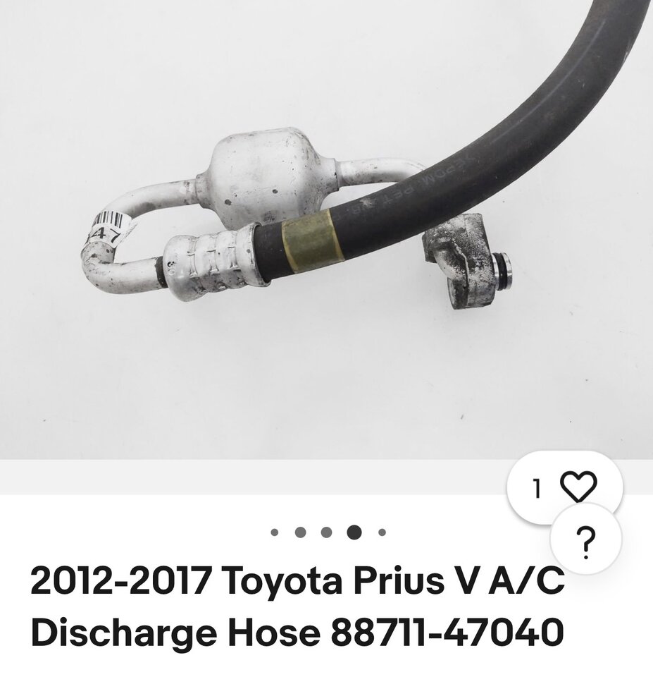

    Your v has a discharge line muffler in the discharge hose.
    Ebay oem used part
    Pressures in this line are the highest in the system. Assuming you are not dealing with a previously replaced compressor due to a burn out, I would buy another used oem discharge line instead of a low cost aftermarket. Be sure the u bend is not being twisted or forced to install the line because of poor alignment.

    Sorry I stand corrected the picture with the Green arrow and the two red boxes is my setup

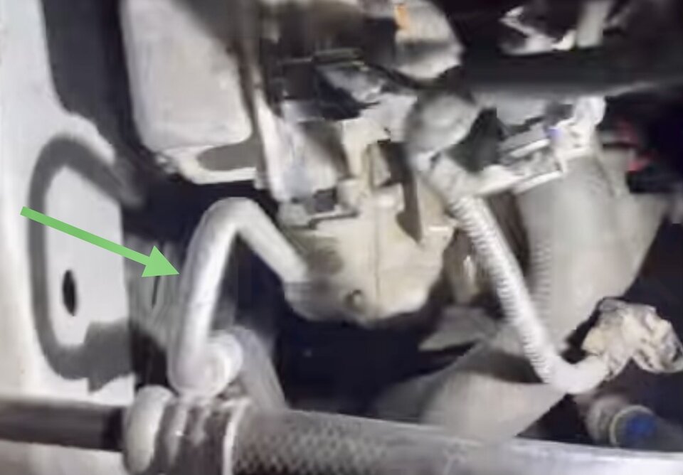

    A torsion flex break
  11. 80sguy
    80sguy Junior Member
    Jan 20, 2023
    Rome NY
    A torsion flex you can see the split just above the bottom bend

    I don't see it, but at least that suggests to look for what is loose and might be causing the torsion loading.

    I blew it up
  16. 80sguy
    Jan 20, 2023
    Rome NY
    I blew up the pic. It's just a hairline crack however the past two times it broke it literally broke away into two separate pieces
