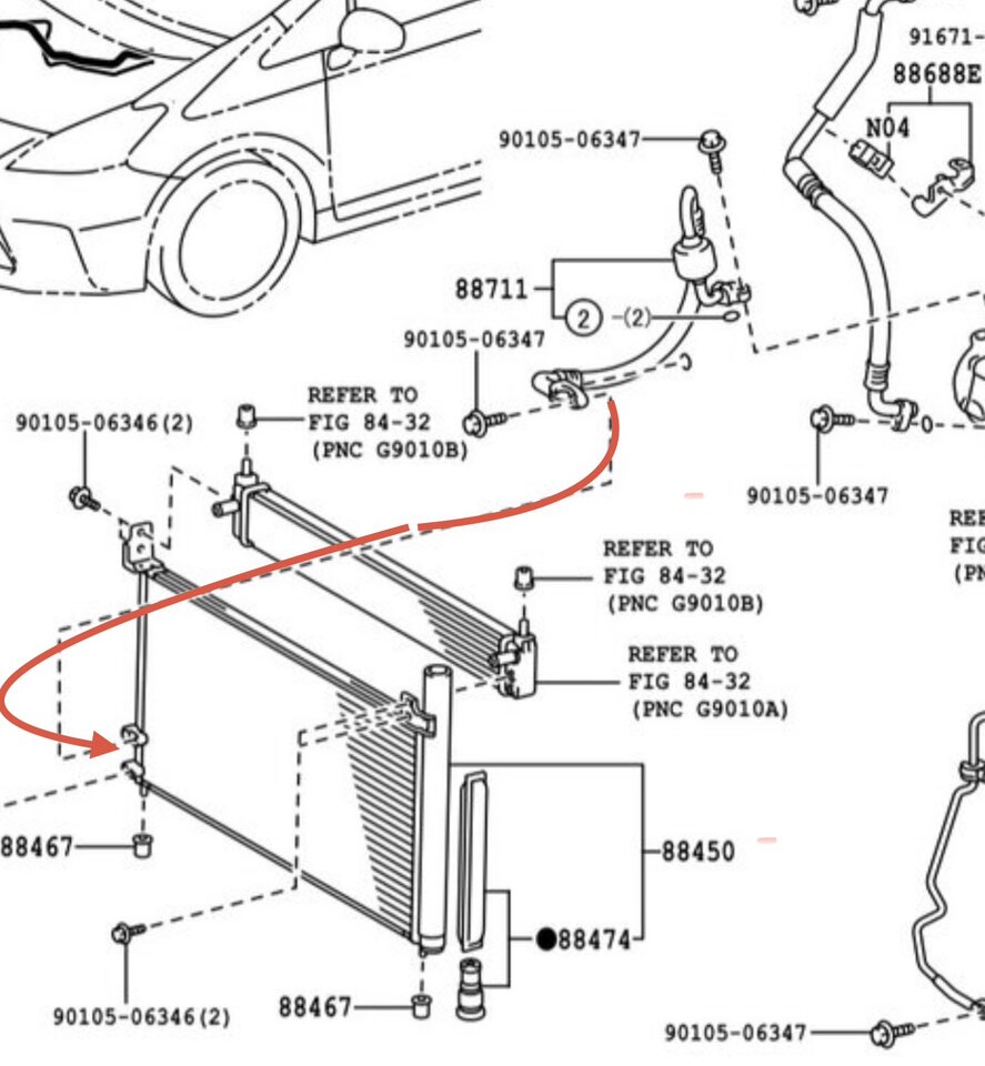

    I couldn't find the hose from the condenser that you speak ofu have a diagram I can
    Art Jay Parker sent a blown up parts diagram and I don't see the hose you speak up on that and I didn't see it on the car. I will put it back up on ramps and look at stuff again. I had the bumper all the way off because I had to fix a fog light. This also gave me a better access to the front portion of the installed line

    The discharge line that is breaking attaches to the front of the condenser as shown by the dotted line (highlighted in red).

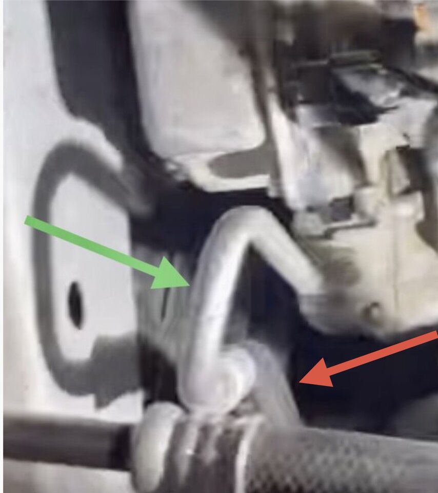

    The discharge line starts as metal (green arrow) and transitions to a rubber hose to reduce vibration damage (red arrow). It then changes back to metal at the condenser.

    RJ parker. Thank you I'm not trying to sound like a smart-alec but I must be missing your point. Yes I know that line that's the one I replaced that's when I first asked about when it broke it is broken twice now. The other guy I don't remember who made it sound like there was another hose I should be checking. This part that has been several times is the hose I'm talking about and I know which it is because I bought two of them.
