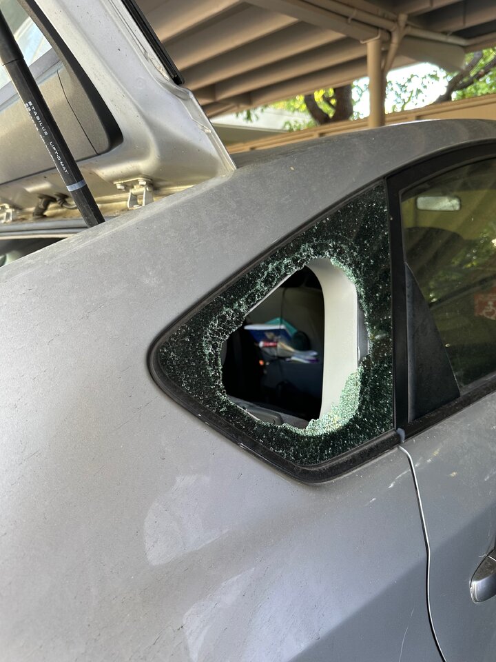

    I hope someone can give me some advice.
    Someone broke the right rear quarter window of my 2013 Plugin Prius and then folded the right rear seat.
    I am trying to figure out
    1. Which part to use (VIN has DP in the 7th, 8th places). I think it is 62710-47130, but I could be wrong.
    2. How do I close it up so I don't have the thief come back in and, this time, remove the battery pack?
    3. That little piece of glass is $215. . Where can get a less expensive alternative?
    4. And yes, I'll probably try to figure out how to do the actual work.
    The insurance deductible is $500. I don't have much incentive... to go that route.
    Thanks

    I wish they were that cooperative. They do more damage than the property they steal.
    I didn't see any wires, though. I cut a piece of ply to the shape and attached a steel wire to the inside. Then I tied the steel wire to the seat headrest posts.

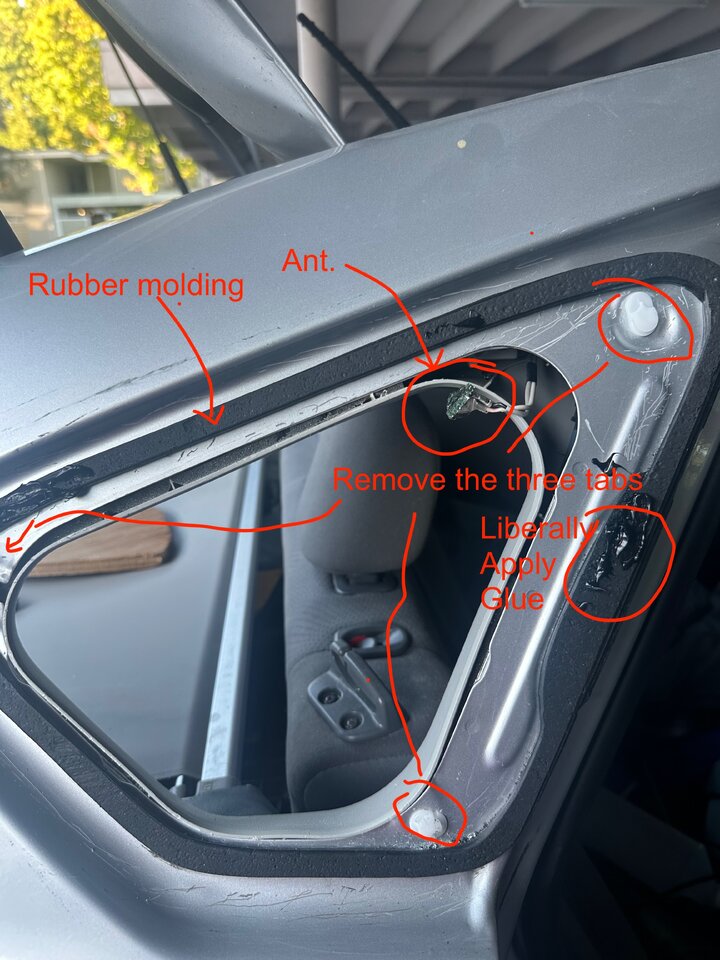

    I was finally able to install a window I got from eBay. Unfortunately, it did not have the antenna. I decided to not complain and install it anyway. Here are a few things I did.
    1. Used a simple wrecking tool to pry out the glass gently.

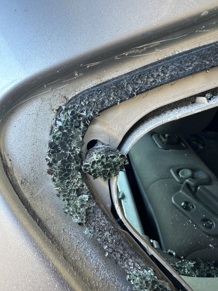

    2. What was left was the shattered glass stuck to a rubber molding ( right word?). Check the first image.
    3. I used gentle, persistent, and time-consuming elbow grease to slowly pry out the glass pieces off the rubber.
    4. There were still tiny pieces of glass stuck to the rubber; i removed the pieces by running my boxcutter over them.
    5. Applied 3M Glass glue:
    6. Stuck the bay glass on it. I had spent some time removing the old rubber.
    7. Used Packing Scotch tape. DO NOT USE Tape like Gorilla Tape, as they leave a residue. Don't ask me how I know.
    Now to find an FM antenna.
    The second image sort of shows what I did.

  9. ChapmanF
    28,694
    18,998
    Ah, so there was an antenna. :(
    I do think the main FM antenna is still in the stalk at the rear of the roof. The one on the quarter window would have been a diversity antenna. I suppose saying that gets me on some kind of list these days, but so help me, that's what it's called.
