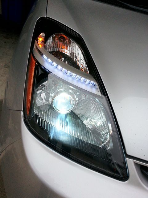

    Hello! Welcome to the Prius family. I too have a 2008. The HIDs suck and the fogs are just 9006 halogens. They are for looks and don't really do anything. Someone on the forums installed bixenon projectors in the stock housings. (Google "HIDs to the max- priuschat" ) It's a morimoto kit, about 315.00. Looks amazing. If you want to get more light, without disassembly of the headlight you can buy a hid kit with 55w ballasts. A good place to get them is the retrofit source, xenonpro.com, ect. Stay away from ebay, xentec, ect. With HIDs you get what you pay for..
    Do us all a favor and don't put HIDs in the fogs. It will blind oncoming traffic. Instead leave it as is or just upgrade the halogens to Match the color temp of the new HIDs.
