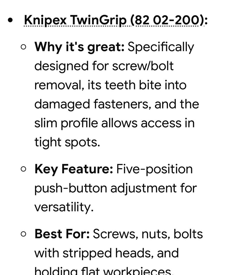

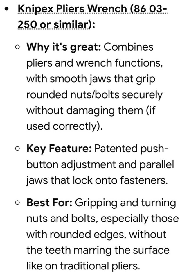

    Bought one of these
    Also bought quality the knipx twingrip pliers. A few extra tools will come in handy somewhere down the line.
    Will keep penetrating lube on it, we'll see if it comes off tomorrow.

    Well, there's no room for the tool to fit in there to grab the bolt end. The twingrip pliers won't do it either. I can squeeze as hard as possible, and it still slides. The bolt is roughed up all over and up and down it. I'm wondering if I can put epoxy in a 6 or 7 mm socket and slide it over the bolt and let that harden, then try to wrench it out. JB weld Steel Stick says it can take 5000 psi. That's the next thing I'm going to try. Unreal that I'd run into this on a simple job, but there we have it.
