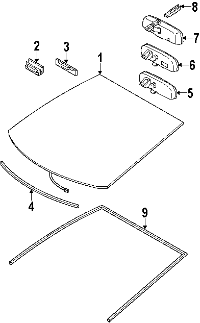

    recently a weed wacker broke my hatch (small) glass and now I broke my windshield. This happened because I had my wipers up and one snapped back down. With the after market wiper, it allowed the wiper to invert when it came down so there was a lot of concentrated force. This resulted in about a 1.5ft crack right up the center of the windshield.
    Unlike the rear glass replacement, I am not opting to do this one myself. I do have full glass coverage via Geico and the total cost of the replacement will be $0. They are sending me to safelite and fortunately because I have the HUD they are putting in an OEM windshield. safelite called me to confirm it will be OEM but it will take a few days to get.
    My only concern is the "Reveil molding", air dam, and windshield stopper. Respectively 9, 4, and 2\3 in the picture below
    I am not sure if safelite will have these or if I should buy them and provide them when I bring my car in.
    Also the way the rear view mirror connects to the car looks scary. Have any of you noticed problems with how it reattaches after your windshield was replaced? I do not have the LKA system but it is auto dimming. The windshield is over $1000 retail but the rear view mirror carries a higher pricetag!
  17. GasSaver1
    GasSaver1 Member
    Jul 12, 2009
    220
    20
    South Florida\Long Island NY
    So the answer is Yes you need "9" and after calling safelite and offering to buy and bring it to them they said they would get one at no cost to me.
