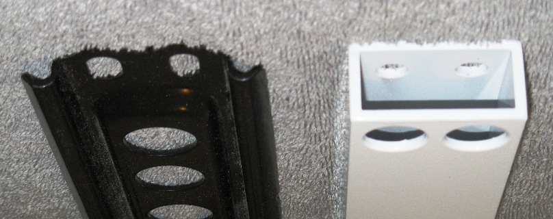

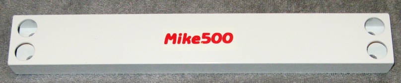

    On the alternative, for other users, my "box beam" brace is a newer technology and uses the OEM bolts.
