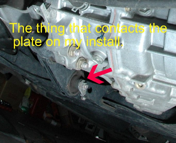

    I'll take credit/responsibility for the unclear photos. I took them to augment the instructions that came with the skid plate and they'll make more sense in that context. But it's also darn tricky to photograph from that angle and include all the details. I can add captions, and have for some of them. If there's a demand I'll do more. My plan is to rewrite Brian's instructions (maybe today) and include appropriate photos.
    I don't know the name of it, but mid-engine/trans torque arm sounds like it might be right.
    No PDF, I have Brian's instructions in word. The only diagram included was a hand-done rough sketch that, honestly, wasn't very helpful. I'm hoping to get those rewritten soon.
    Not exactly....

    In my opinion, any mechanical interference issues with the skidplate ought to be, for sure, cleared up ASAP. Unless I missed something, it appears that Evan's plate does indeed contact that mount thingie in the center of the car (despite his efforts to make adjustments); personally, I wouldn't be comfortable leaving the plate in place for an extended period of time under those circumstances.
    Perhaps that specific skidplate is an early unit that isn't exactly to regular production specs, or something like that, I don't know...?
