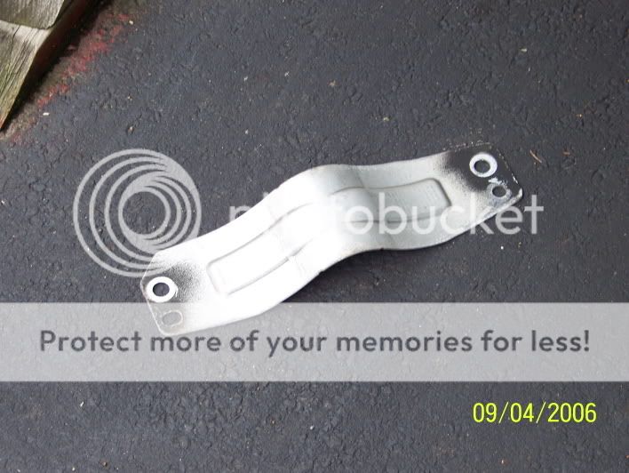

    This is interesting. The Volvo S60R had a similar bracket:
    The first mod a new S60R owner would do was to remove this bracket completely. The particular bracket was mystery as to why Volvo installed it in the first place. Some said it was to keep the drive shaft from falling off (AWD car) or exhaust in case of catastrophic failure. Some say it was to facilitate the installation of the exhaust at the factory. The problem with this bracket was that it hung low to the ground. It was suceptible to bottoming out. When it did, the bracket would bend upward hitting the exhaust and then push the resonator into the driveshaft. The end result would be $2000 in damage (new exhaust system and new driveshaft). It happened to me.
    S60R ownes would replace the bracket with a cable, thinking that would be enought to hold the exhaust or driveshaft in case of failure.

    I guess what I am wondering is if the Prius's center bracing is similar to the Volvo's in that it is to keep the exhaust from falling to the ground in the event of failure.
    Here is the bracket before bottoming out.
    Here is the S60R bracket after bottoming out.
