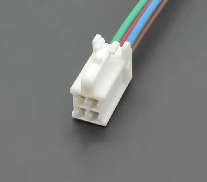

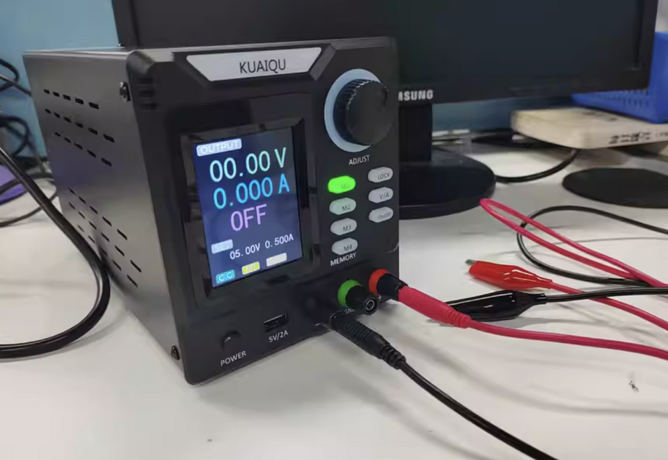

    I bought the adjustable DC charger KUAIQU SPPS-D3001-232 (0~300v, 0~1A) for charging the battery and 90980-12474 4P wire connector harness plug too to hook up with a 12v charger for the fan.
    Haven't tested yet though.

    Wow! That device is only $67 and can be used for so many different things beyond a charge and balance for NiMH... What you did pretty much makes this thread obsolete. I think I'll ask moderator to close this thread so it end with pointing to Jack's link and your link: https://www.aliexpress.us/item/3256806709273120.htm
