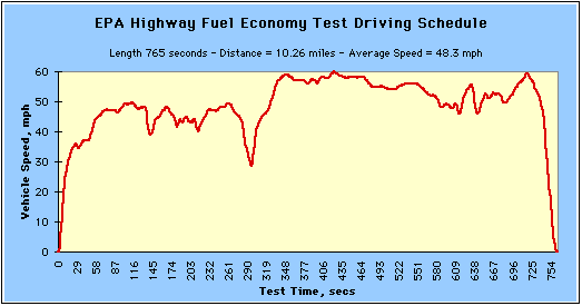

    The EPA chart is a just one kind of testing cycle - City. NEDC is combined 2/3 city and 1/3 highway. I'm adding the EPA highway test cycle, just for the completness.

    Just to add more to the toyota games the "EPA" discussion I found some interesting plots on power-demand for the EPA city cycle
    As you can see the power demand is actually highest at some intermediate speeds, which is likely where the ICE is needed, not for speed but for power. (The curve is for the rather interesting edison prototype EVLC car so its not a requirement of EPA, but a measurement from their car. (The negative kw is because of regen). But since the EPA driver is trying to match speed and acceleration its a pretty good estiamtion of the demands.
    You'll notice the max speed in the test is 56MPH, (verified by looking at the actual data in the test). so if Toyota was just gaming to say in EV for the the test they probably would not have gone for 62.. its not just speed.
