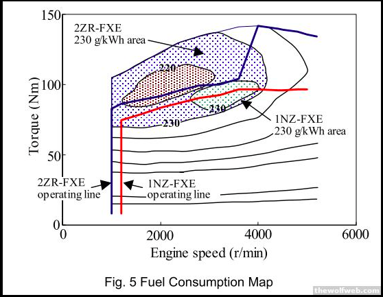

    Look at this SFC for the Prius G2 and G3 engines:
    What power do you get when you use a torque of 80 N*m and 1800 rpm ? I wrote the equation for you a few posts earlier; you only have to plug in numbers and multiply and then divide for the answer ...

    The big 2.5L engine in my new 2014 Subaru also has to spin a bit over 3000 rpm at that highway speed. The same size engine in my previous Subaru had to spin at least 3600 rpm. And the little 1.6L engine in my partner's '80s-era Integra (considered very fuel efficient for a nonhybrid as recently as five years ago) has to spin over 4000 rpm at that speed.
    Looking at a G3 BSFC chart, I think that at 2500 rpm, it is putting out about 32-34 horsepower. And watching the ScanGauge while returning home from a trip yesterday, that was about right.
    At steady speed on level road, my little Prius engine always spins slower than my big Subaru engine. It takes an uphill slope of several percent before the Prius spins faster.

    Is this math result correct ?
    About 80 N*m Torque
    Power (in kW) = 2.5 * pi * 2 * Torque / 60 = ~ 21 kW
  18. fuzzy1
    17,710
    10,444
    When I actually wrote most of that reply over the weekend (posting from remote location failed, and I remained offline since), I was reading a different version of the chart, with a vertical axis marked in 20 N*m increments. It looked to me as producing 90 to 95 N*m, not the 80 you figured.
    Looking at the chart you posted, I'll stick with that 90-something N*m. Blue line is Gen3, red is Gen2?
    #38 fuzzy1, Jul 3, 2014
  19. SageBrush
    SageBrush Senior Member
    Jun 4, 2008
    11,627
    2,533
    Southwest Colorado
    That was my guess too.

    So the 1.8 engine makes about 28 horsepower @1900rpm. The 1.5 engine from the "C" is about 24 on that chart above. The 1.8 can overcome 80 miles/hour air resistance but I'm not convinced the C could, but obviously you know the car better than me.
    Anway I'm trying to figure where we're in disagreement: Smaller engines produce less torque than bigger engines (given equal RPMs). The chart you posted shows that. (shrug) I'm starting to wish I had not come to the defense of the Businessweek author.
