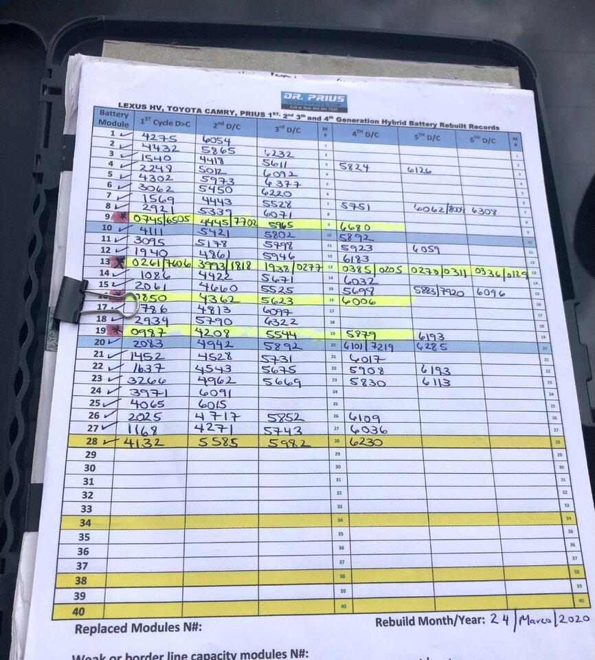

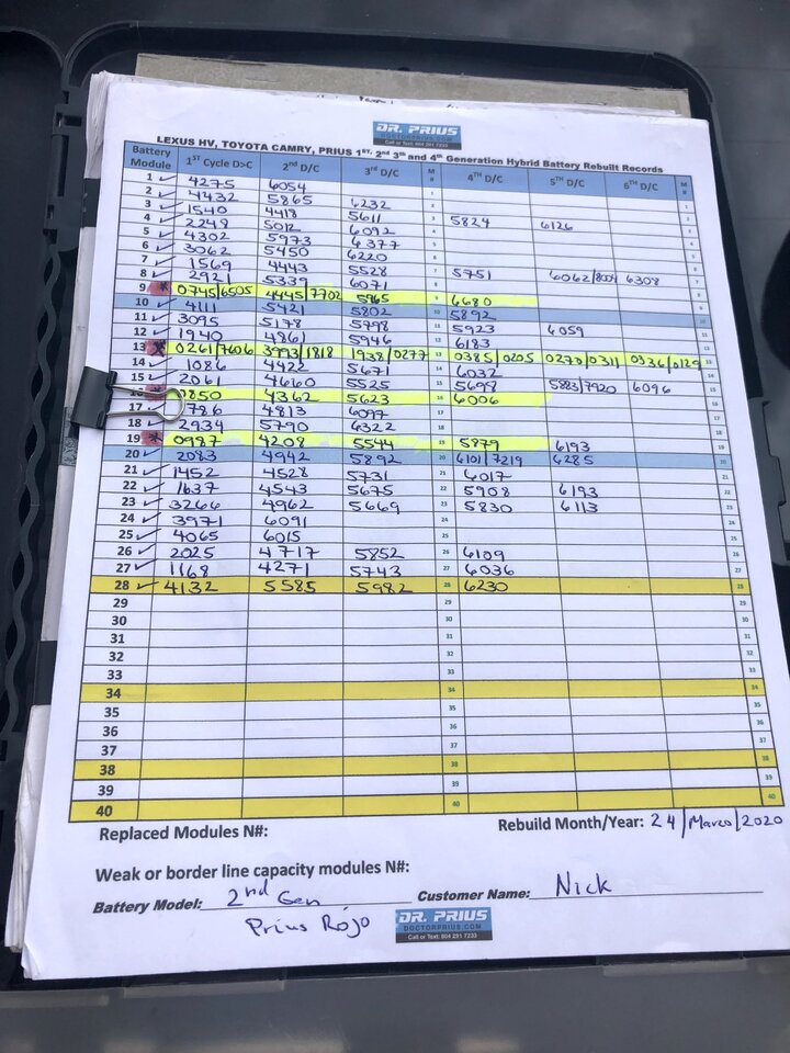

    Here is my update too. It has been 11 months and 8000 miles since Doctorprius.com rebuilt my battery and still runs strong. MPG also remains high at 42 as it used be years ago. The last couple of years before the repair was creeping down close to 38.

    Just an update on my battery, 20k miles and 21 months later battery still working fine.

    Final update: The HV battery that was rebuild in March 2020 with replacing 4 modules lasted 5 years until February 2025.
