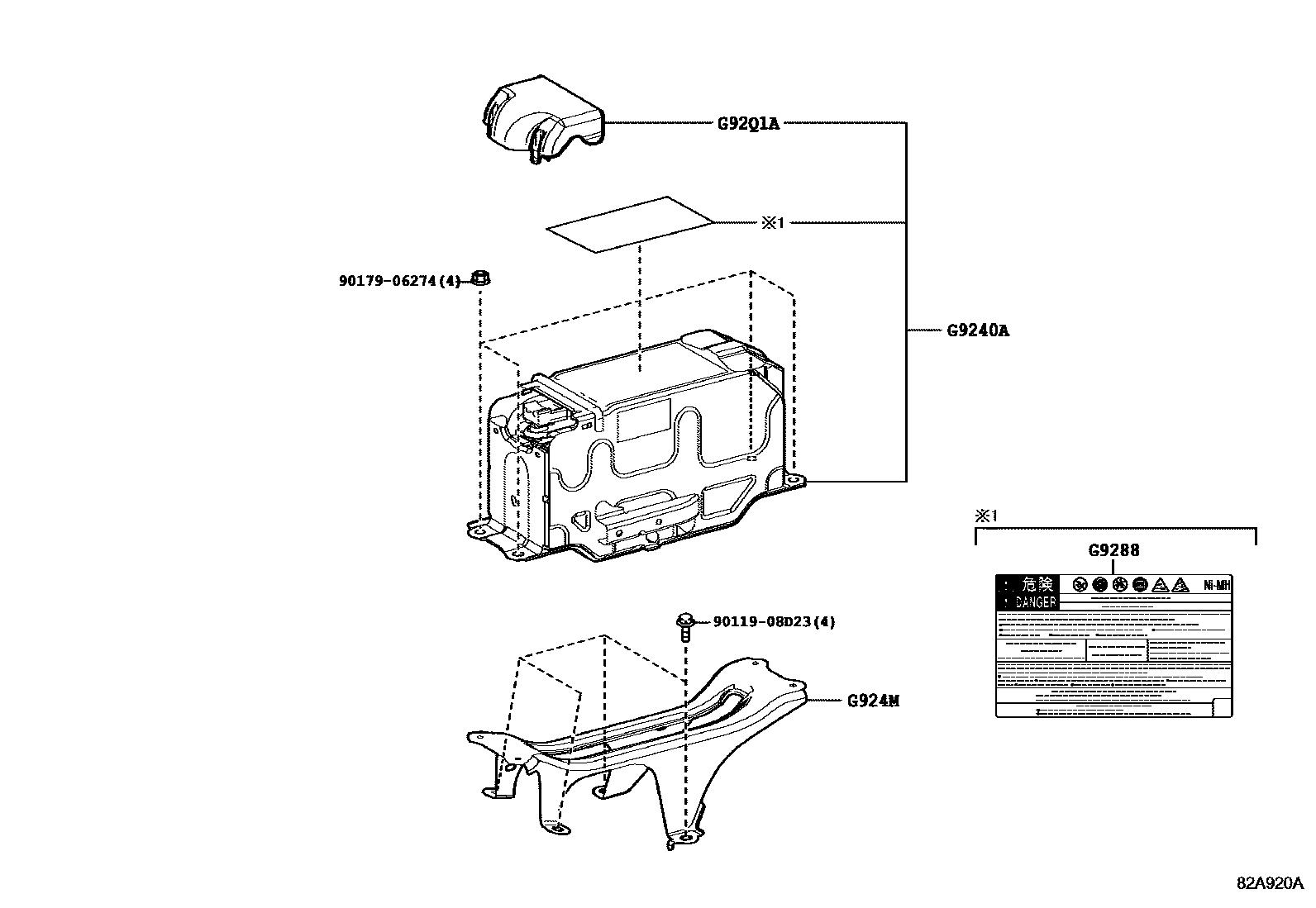

    the solar battery

    I think what @bisco is talking about is the small NiMH battery that the solar roof charges. This battery then charges the Li-Ion traction battery in the Prime. The solar roof doesn't actually charge the Li-Ion battery directly.

    The solar battery is part of the solar roof system that is optional in other markets.

    The solar panel augments the 12V only when the vehicle is on.
    When parked, it can top up the battery (via the small NiMH battery), allowing for 1,300km of solar EV driving assuming an annual average of 3.5km per day.

    Ah, OK, so can it actually charge the traction battery through the solar battery? What is the capacity of the solar battery in terms of kWh?
