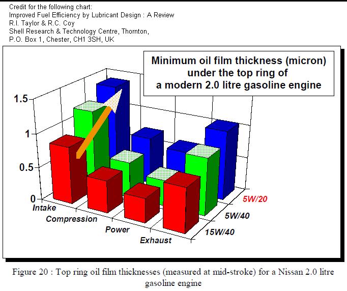

    Hi uart, I agree, but don't forget the other moving parts. Piston rings and some parts of the valve train have oil film thicknesses much thinner than in the crankshaft and camshaft bearings. Some parts such as the timing chain and tappets, run by design with oil film thickness approaching zero no matter what the oil viscosity. Such parts are kept alive mainly by the anti-wear additives in the oil.
    So at least theoretically, there must be some wear reduction benefit from also filtering out particles that are much smaller than the minimum oil thickness of the bearings. Whether it is cost effective is another question. Yet another question is if it would help prevent excessive motor oil consumption in high milage Prius engines.

    Hi Fred_H,
    Exactly! For now I've settled for a Z432HE Full Flow Oil Filter.
    A Great graphic...
