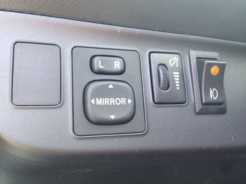

    Got my lights hooked up finally!

    Guys, I used kwhubby's method probably over a year ago and am just realizing that my dash light indicator doesn't work... I'm using a switch that has an indicator light of its own, but I'd still like the one on the dash to be illuminated. Anyone have an idea on how to fix that?

    getting the lamp on is actually pretty easy. just need to splice a cable. but that cable is so damn thin and packed. I have what you have, a separate switch that turns on as well as the dash.
