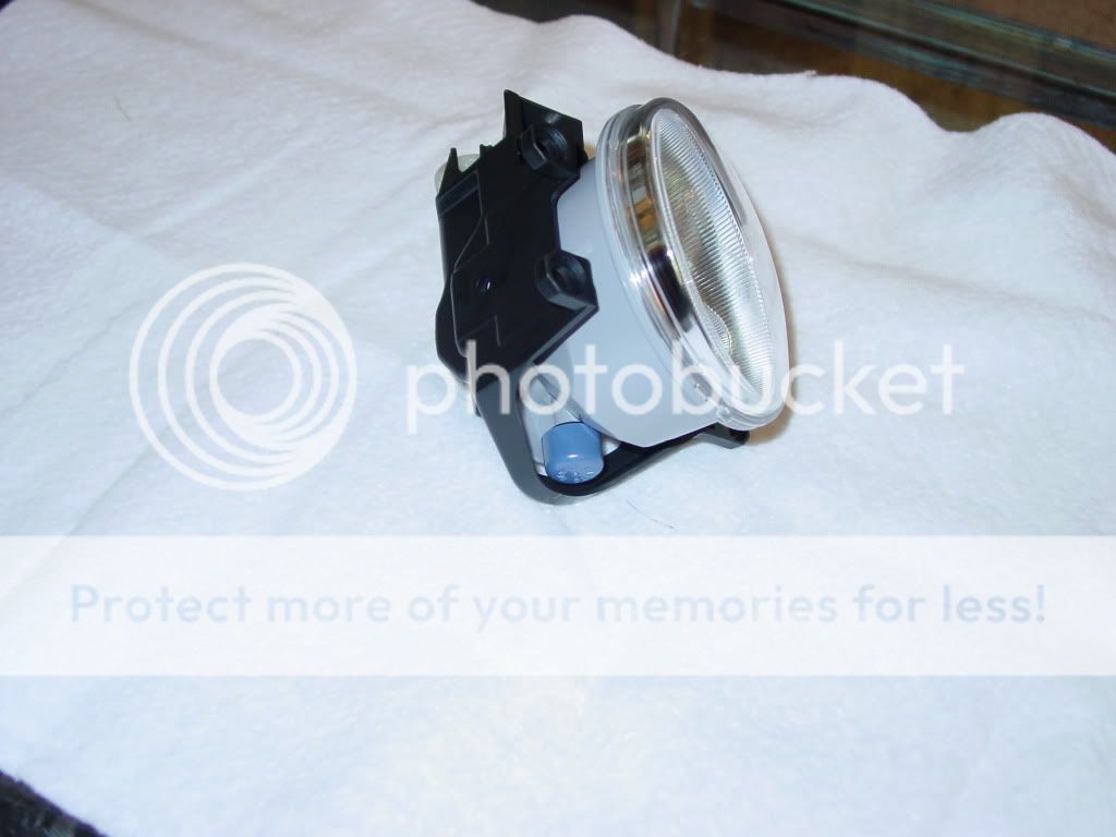

    looking at LED bulbs for the fog lights. The book says H16 and an H16 19w bulb is what the one inside the light has writen on it. But it looks like an H11 I tried the H11 in it and it kinda fit anyone else have any experience? Mostly was wondering about wattages don't want to get too hot, but with LED would I not have to worry about that problem.

    The Bulb is an H16 19w thats what it says, got the bulb in front of me only have the right fog light right now waiting for the other side and the stalk, but this is whats printed on the back
    OSRAM
    H16 12v 19w U
    64219 L +
    Germany [E1] 2z3
    w2e 2
    Thats all being said an H11 will fit in it but like its been posted before a 55w will likely be too hot and melt the housing.
    I have not been able to find H16 bulbs on the internet the ones I find are the 5202 which are fog lights for GM vehicles and have a diffrent fittings on them. Also not able to find anything on Sylvania's website. I will look through some catalogs at work tommarow to see if I can find a replacement bulb but its odd not being able to find a replacement.

    Thats the one I keep on finding online but this is the one thats actualy in the OEM housing
    [​IMG]o
    The bulb looks like an H11 and the H11 does fit into the housing.
