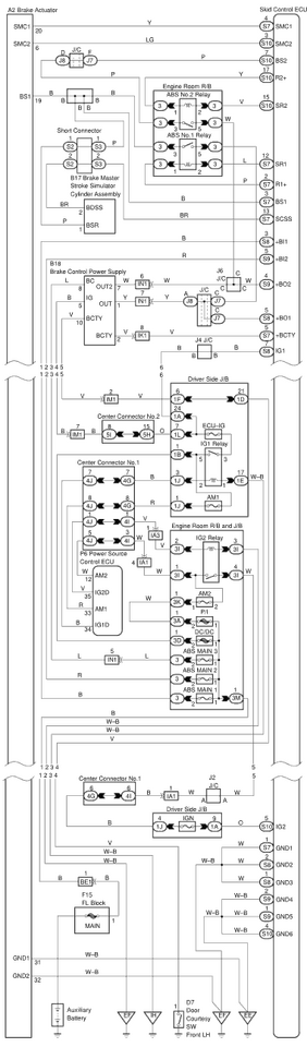

    BS1 relates the ABS No. 1 relay and BS2 relates to the ABS No. 2 relay. You might want to check you have voltage at the ABS No 1 relay and that this relay functions correctly.
    The other notable anomaly mentioned in Chap's post is the value of the detailed freeze DTC. As a programmer 256 (2^8) and 512 (2^9) stand out as possible translation error defaults. As Chap mentions, the FFD detail code should be 81, 82, 83, or 84. While this is unhelpful and may be a needless distraction, I believe that looking into what is causing the voltage discrepancy on those voltage input lines might be productive.
    Before starting any diagnostic effort, ensure the 12 V battery is fully charged and tested that it holds voltage under load.
    You might find the attached troubleshooting inspection procedure that contains the wiring diagram excerpt for this DTC.

    dolj already called it. Your brake electronics include two redundant systems: system 1 and system 2. (The guys naming the systems were not feeling super creative that day.)
    Your freeze frames show system 1 getting pretty much no power, whether looking at IG1, +B1, or BS1.
    As the diagram shows, BS1 and BS2 are supplied by the brake backup power supply (the capacitor box in the rear of the car), through ABS No. 1 and ABS No. 2 relays, respectively. IG1 and IG2 are supplied through the IG1 and IG2 relays, via the ECU-IG and IGN fuses, respectively. +BI1 and +BI2 come from the ABS MAIN 1 and ABS MAIN 2 fuses. (The ABS MAIN 3 fuse it what supplies power to the brake backup power supply.)
    Finding out why zero, or close to zero, voltages are seen on multiple system 1 inputs might call for a neat bit of troubleshooting. The troubleshooting steps here might help.
