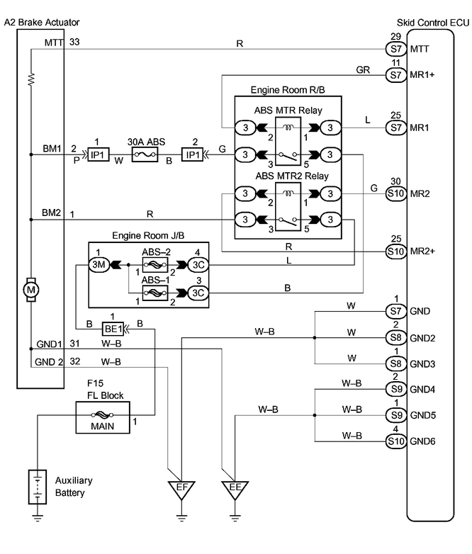

    The wiring diagram I have shows this:

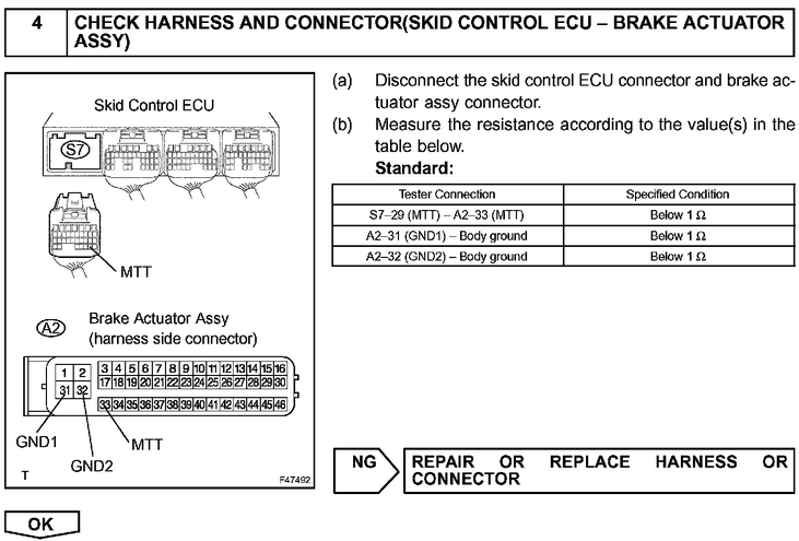

    And the Toyota test procedure is to check resistance from pin 33 at the actuator -- the source of the voltage -- to pin 29 on the S7 connector on the skid control ecu. That measured at 0 Ohms of resistance:
    I haven't tried a voltage drop test across that wire, so it's possible there could be a drop, but I do get the exact same voltage reading when I backprobe the A2 pin 33 and the S7 pin 29.

    Looking at the wiring diagram there is a single wire straight from the SCU MTT pin to the ABS one. 7.x volts at both ends, yes? If the SCU is reading an MTT voltage of 0 it must be doing it internally or there is some other logic error preventing it from reading it at all. How exactly does the ABS report what the SCU says the MTT voltage is? Is this a Techstream value?

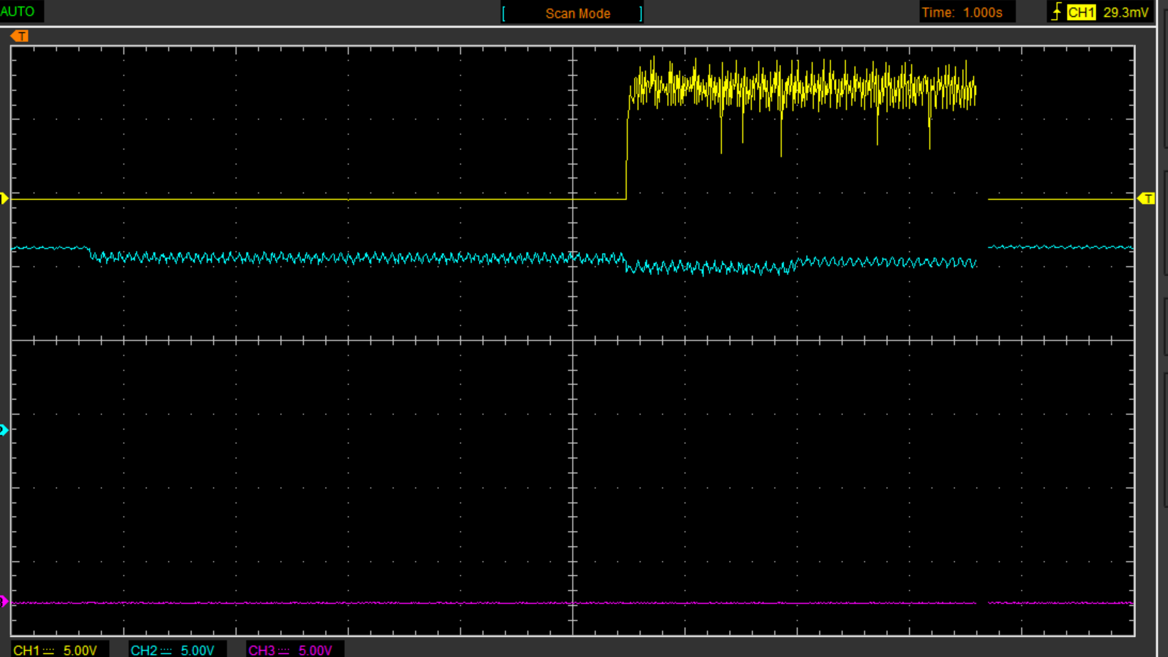

    The car came back home the other day so I grabbed the new-to-me Skid Control ECU and plugged it in. I didn't bother physically removing the old one yet; I just pulled the lower dash panel and popped the four connectors (S7-S10) off the installed unit and plugged them into the new one. After the reset and relearn, I had the exact same problem. So the issue is not likely to be the skid control unit.
    Next up, I hooked up my scope and connected channel 1 to the MTT pin and to ground, channel 2 to the MR1 and MR1+ pins, and channel 3 to the MR2 and MR2+ pins. So, in theory, I should be seeing the input to the skid control ECU from the motor as well as the outputs to the relay control for each of the ABS motor relays. Baseline:
    When I power the car on, both relay control channels spike, but the MTR1 voltage remains high.
    After pumping the brake pedal a few times, I could hear the motor run and got this result:
    So far, so good, in theory, right? So on your recommendation, I pulled out the MTR1 relay and then pumped the brakes a bunch of times. The motor did not run at all:
    So I can confirm for certain that the motor does not run unless the MTR1 relay is in place. I checked continuity between my backprobe and the pin on the connector so I can confirm that the backprobe is inserted fully.
