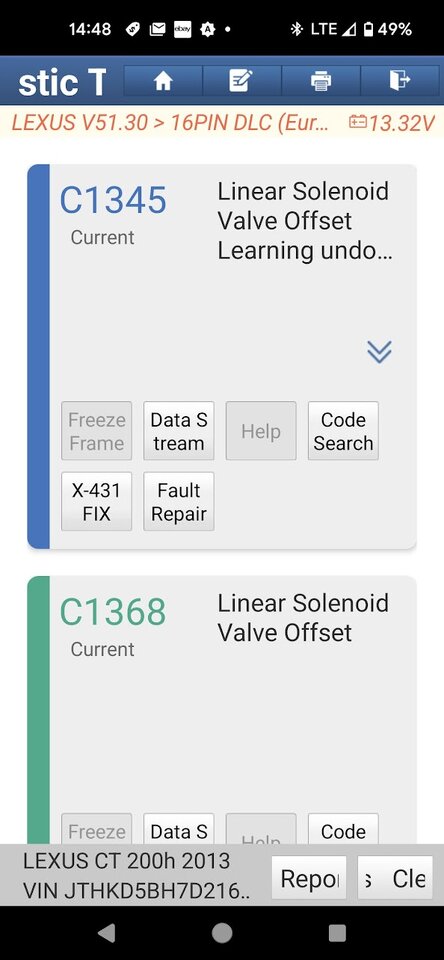

    I can describe since I have this problem after replacing brake booster and pimp twice.
    Done bleeding many times after replacement according to procedure but it couldnt learn linear offset no matter what, during procedure brake light blinks slowly and after 120 seconds stays lit, no fast blink.
    Battery maintainer always hooked up, no air in system, no other codes, tried disconnectiong battery wait then procedure - no luck. Tried with Launch, Autel and Techstream - same result. Accumulator doesn't drop pressure and operates as it should as far as im concerned.

    The repair manual also gives a "when not using the Techstream" procedure for learning the solenoid offset. Just done with a jumper wire.
    I ended up doing that recently because I wasn't able to do it with my Autel AP200 (for some reason; I'm not saying it had to be the AP200's fault, only it didn't happen to work that time, and I just said "fine, I'll try the jumper way").
    Toyota Service Information and Where To Find It | PriusChat
    When the learning procedure happens, the light does a slow blink for a while and you can hear the car repeatedly applying the brakes with different amounts of pressure and releasing them, and at the end the slow blink turns fast.
    If that stuff doesn't happen, you haven't managed to make the procedure happen.
