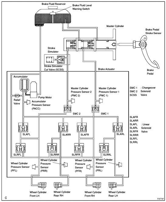

    This is about the RR brake fluid pressure sensor, not the wheel speed sensor.
    The pressure sensor is located in the brake actuator. The signal gets from there to the skid ECU on the wire between connector A2 pin 41 and connector S10 pin 31. That should make a good low-resistance connection (less than 1 Ω) between those two pins, and high resistance (at least 10kΩ, usually a lot more) to ground or anywhere else.
    How high did the water get on the car? Did it get in the cabin?
    I would certainly check out the wiring connections before assuming the actual sensor in the actuator went bad.

    No, they don't. C1364 is about one of the wheel cylinder pressure sensors, not about any wheel speed sensor. The wheel cylinder pressure sensors are located inside the actuator assembly, not at the wheels. They are not separately replaceable. See post #3.
    Your 243 subcode refers to the sensor shown as PRL in the diagram above, which measures the pressure to the rear left wheel cylinder. I suspect the "RR left" is more a typo or translation-o. The description also says PRL, which is unambiguous.
    Although the pressure sensor is inside the actuator, in gen 2 the ECU is not. Therefore, there are wiring connectors and wires to check on the path from that sensor to the ECU, and given your observations about humidity, I would certainly check those first, before deciding the sensor itself (and therefore the actuator) needs replacement. More details were in post #3. As far as I know, pressure transducers don't really go bad very much.
    That 'dongle' is nothing more than a resistor, so no.
