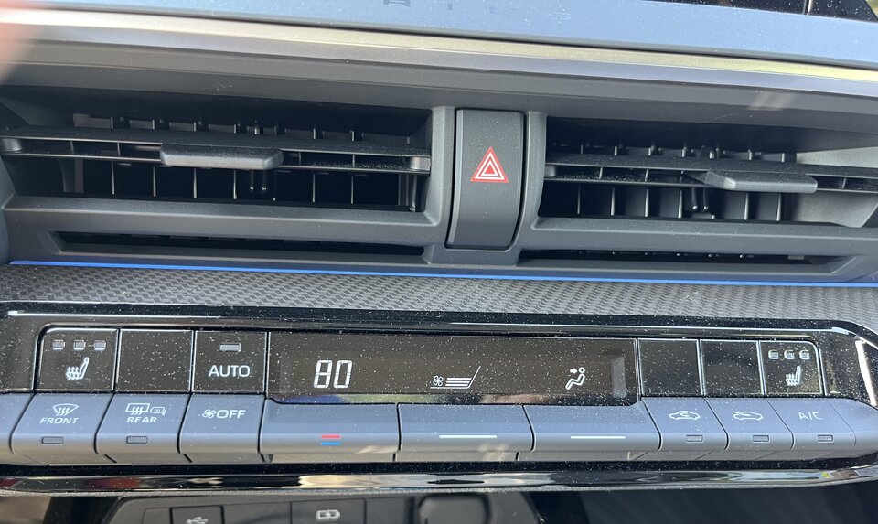

    Thank you. I spoke with Longo Toyota parts today and they actually took the time to examine both carbon air filters. 87139-7620 MSRP $52 has a different weave and apparently thicker carbon than 87139-YZZ93. I think I’m going to try the thicker one since it’s 50% off this weekend.
    In the mean time I’m still not clear on what’s going on with HVAC despite having read the AC section in the manual twice. I have everything shut off except the fan and I’m getting cool air coming in. I put temp to 80 to see if the air would heat up. Goal is to manually control so I can avoid mold buildup.

    Okay, this was hashed out ad nauseum in another thread, but that was a year or two ago and it's probably buried 10 pages down by now.
    In previous generations(like your gen2), the A/C was controlled by the driver even when the climate control was set to AUTO. So you knew whether the A/C was enabled or not by the A/C light. This is not the case on the gen5 by default. From the factory, the climate control now controls the A/C just like everything else. It's not going to turn the light off and on, just like it doesn't indicate when it changes fan speed or changes the outlet vents.
    If you really want it to operate the old way, you can still do that. In the settings on the infotainment display in the climate section, there's a setting called 'A/C to AUTO' or something like that. It's on by default, but if you turn it off, the climate control will function just like your gen2 did and the light will indicate if A/C is enabled.
    If you want the climate control to control A/C most of the time(A/C to AUTO = On), but sometimes you want to override it, then you can temporarily disable the A/C by pressing the A/C button twice. The first press forces it on and the light will come on. The second press forces it off and the light will shut off. The A/C will then stay shut off until either you manually turn it on again or you press the AUTO button to let the car retake control of it. (I'm not sure if the A/C stays off after shutting off the car. It might go back to car-controlled after restarting.)
    Personally, I'd just leave it alone and let the car handle everything unless/until you actually get a mold problem. This is not the mostly stupid system of your old gen2. These modern systems are loads smarter and take data from many different sensors. They will monitor inside temp, outside temp, humidity, & other stuff and then use a more complicated algorithm to decide if humidity might be building up in the A/C box. The system will adjust fan speeds, inside/outside air, and cooling level to keep things good. By taking control of the A/C yourself, you're handicapping the system from doing its job. But that's just my opinion(which is taken from TheCarCareNut).

    Thanks for clarifying. I did try searching because I remember reading a post about it but only found “How does HVAC work” with only two posts and no explanation.
    I will check on my screen today. I did press the AUTO switch and the light came on but when I stopped and started up again the AUTO switch was off.
