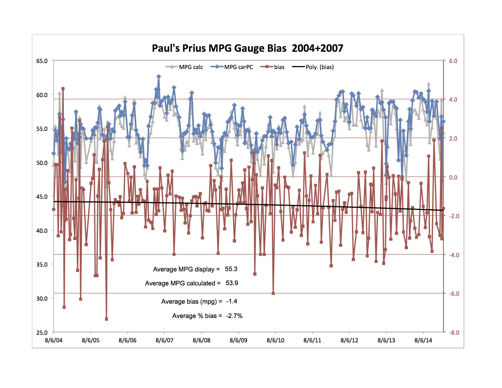

    I've got over 10 years of data across a 2004 and 2007 Prius. My bias shows 1.4 mpg delta between the car computer display and the fill calculation. http://www.enerjazz.com/prius

    Try plotting your MID(dashboard) mpg versus your PUMP mpg and see how close/far their coincident "line" is from 45º degree angle.
