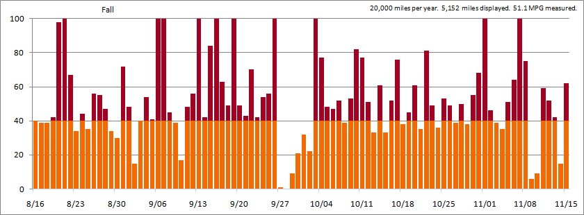

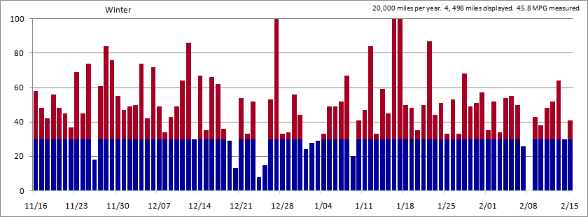

    6 months later, I've collected enough real-world data to write the next chapter.
    Rather than using generic estimates, there's daily driving detail available. See:
    The information in this new document tells an interesting story.
    Of course, we all had a feeling that the "230" claims were just ideal condition claims anyway. Now, you can see that along with info stating why.
    Let me know what you think. Data collection continues for another chapter.

    Daily driving detail is something I could easily provide. So, I have. And it has turned out to be quite revealing... helping to confirm what we had always suspected.
