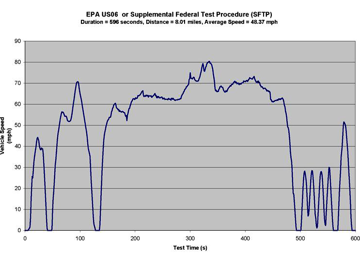

    A PHEV needs a Minimum Certification Range Value of 70 miles, and a Minimum US06 All-Electric Range Value of 40 miles. What is the difference between those two values?
    ZEVs need a minimum certification range of 200 miles.

    1. PHEVs need to have at least 70 miles of EV range and at least 40 miles of US06-cycle range. The US06 cycle includes several bursts of moderate acceleration and a momentary top speed of 80 mph.

    Here are the full details of the EPA US06 test cycle.
    EPA US06 or supplemental federal test procedures (SFTP) | US EPA

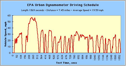

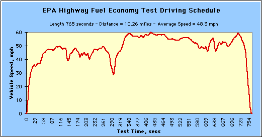

    Here are the EPA "certification range" cycles—UDDS (urban) and HFEDS/HWFET (highway):
    certification-range value = 0.55 × urban all-electric + 0.45 × highway all-electric
