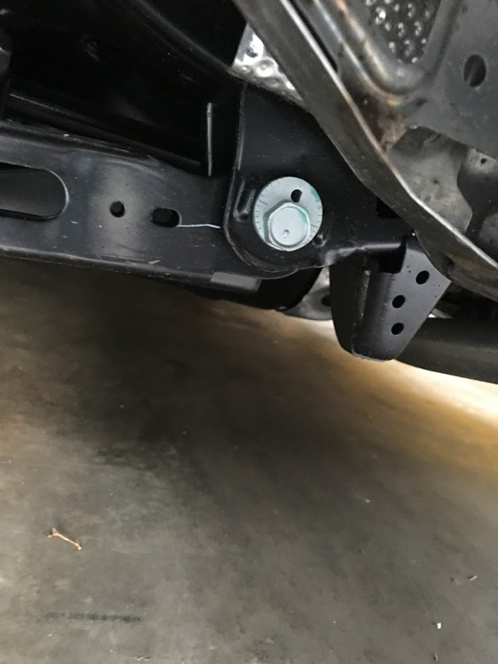

    Are there factory camber bolts installed on the front struts for the 2016MY? If no one knows, I may just remove the front wheels to check for myself. If the front camber isn't adjustable from the factory, does Toyota offer factory "crash bolts" to adjust front camber?
    Taking a peek at the back, it appears the new independent rear suspension has factory eccentric bolts for camber adjustments.

    Yeah I notice that in the flurry of pictures that came out after the Vegas reveal, sure looks adjustable.
