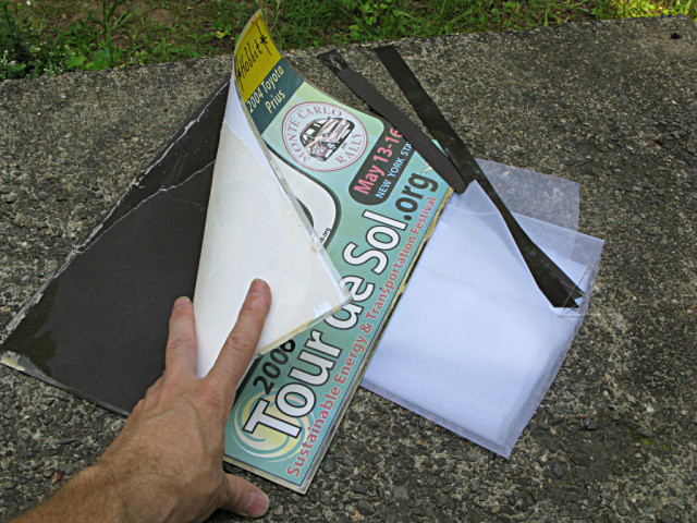

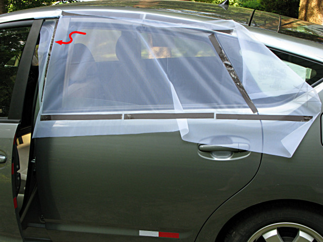

    Did you ever get your answer? I saw a post where a man had made a netting sleeve that slipped over the door and magnets held the bottom flush against the car. The door could still be opened and closed without dislodging the netting.
