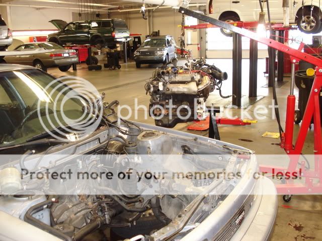

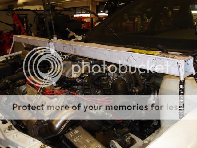

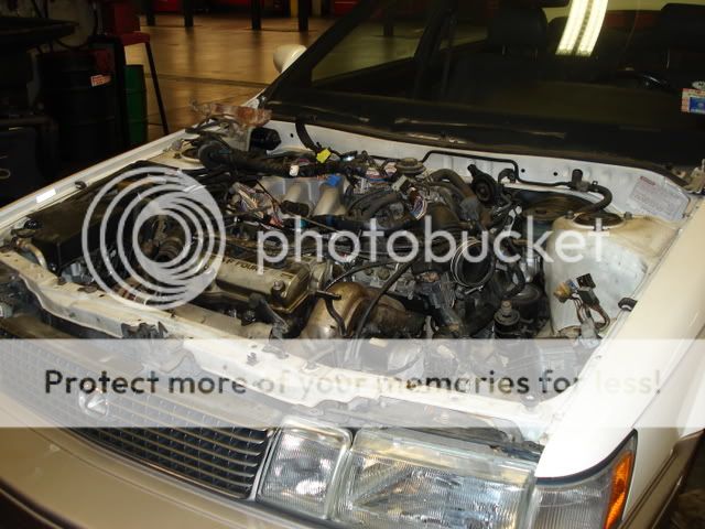

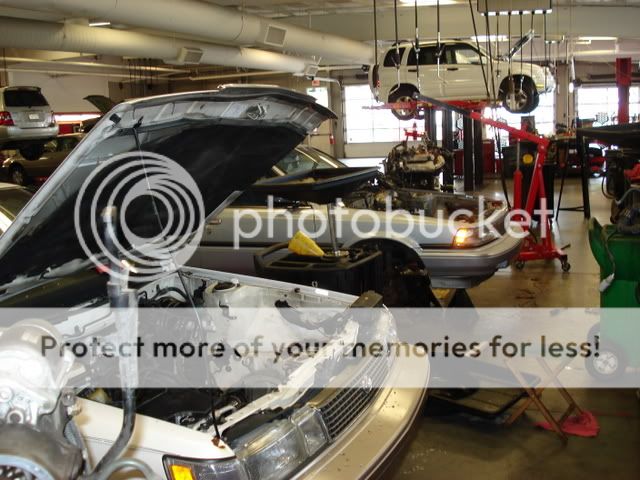

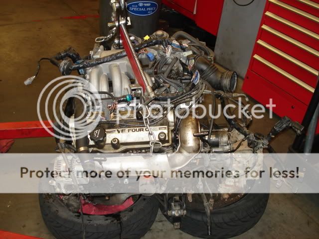

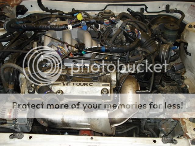

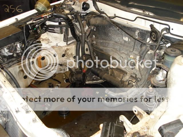

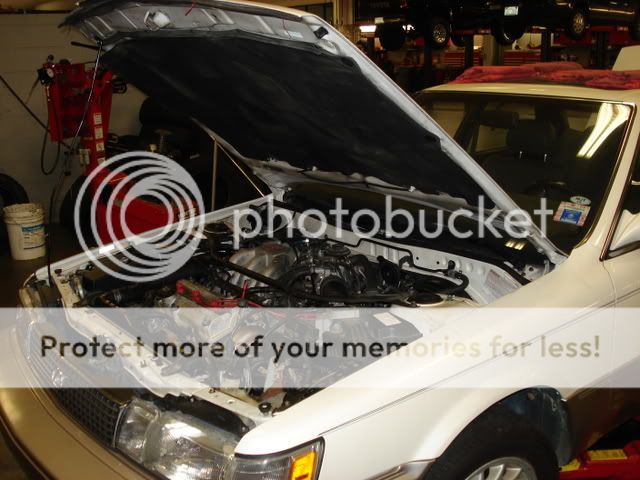

    engine and trans are out of the ES. fortunately, the camry engine-trans removal will be much cleaner than this, that engine compartment was a mess. the camry is much cleaner, no oil leaks or anything.
    first few things out of the way
    shot of the engine in there
    hooking up the cherry picker
    and it's out of there
    engine compartment pretty much empty
    engine and trans in their current resting place

    :lol: and imagine, he did all that in like 3 hours! he can do work on our cars after hours so long as he follows their rules. otherwise this would have been much harder.
    everything's here but the rack- that should come in on tuesday. if you look in the empty engine compartment pic, you can see the old rack still in there- the black tube way in the back toward the bottom. it's so simple to replace with the engine out. we're just going to reuse the old solenoid, it was obscenely expensive to buy another.
    so once that's done, he will do the same thing to the camry as he just did in all these pics. chances are the engine and trans will come out separately, though. then the engine wiring harnesses have to be swapped out, couple other little things to swap, and finally it can all go back together. he isn't working next weekend so that will probably be when the rest happens.

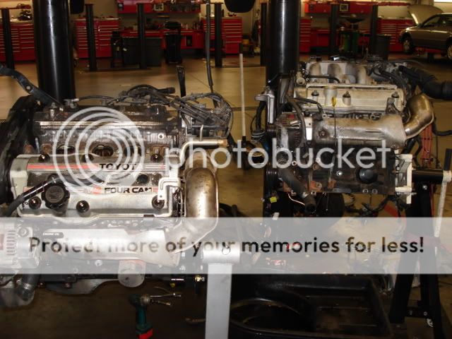

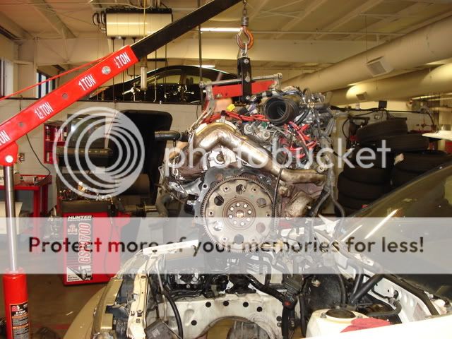

    plans cancelled on me tonight, DH is out, i have some peace and quiet... so what else did i do but get comfy and upload pictures. :p here's an abbreviated overview of the rest of the process:

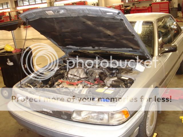

    camry with engine.
    camry and engine, separated.
    recipient, donor, and engine in question.
    engines side by side, after swapping wiring harnesses, intake manifolds and front valve covers- the one on the left is the bad one.
    engine dropping in
    engine hanging by a couple motor mounts and the bar

    and the cause of the knock in the old engine: a rod bearing. the thing was toast anyway, the block was a real mess. he saved the heads, and the rod bearing for amusement value of course.

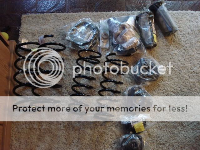

    DH had a back procedure done a couple weeks ago (discogram, highly painful) and spent a lot of time laying down since. he's finally cleared to go back to work so the project is up and running again.

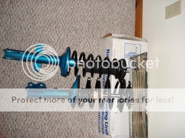

    OEM parts.
    gabriel guardian struts.
    one front and one rear strut assembled.
    two of the struts were bad, unfortunately. he discovered this on monday evening. i called up the place we bought the struts on tuesday afternoon, the guy there was really nice. said he would double check the struts personally before they went out. this morning i received a ship notification with an anticipated delivery date of friday. so these guys are good to deal with and have really good prices- cerell distributing company known on ebay as "stocklifts"
    anyway, hopefully this will be done on saturday then, and since the brake line needs to be disconnected we're gonna flush the brakes too.
