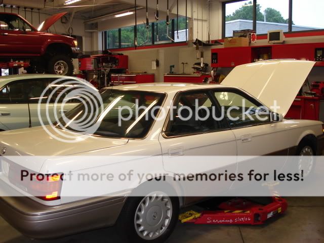

    struts got here last night, he got everything assembled early this morning. today is his day off, but since it's a business day over at the shop (despite it being slow as hell) i'm not able to hang out and take pictures like i usually do.
    when i stopped by to bring him a few things, he had the front struts done and was just finishing up the trans pan gasket. the underside of that engine compartment is 100% clean [​IMG], no leaks! he is the gasket master and damn proud of it.
    trans pan looked good for a trans with about 150k on it... a few small shavings and the fluid wasn't perfect when it drained out. but again, not bad for a trans at 150k. not bad at all.
    we didn't get to the bad rack in the huge rush to get the engine/trans swap done before we left on vacation. so that's going in today, too, after the rear struts and a quick test drive. the inner tie rods are totally screwed, so once the rack is done it'll fix that issue. the new(ish) tires on it have some pretty nasty edge wear because of those bad inners.
    got a new RH headlight assy to replace the broken one, it pointed very low. the front bumper's gotta come off for that job, but hopefully he'll be able to do that today too. :)

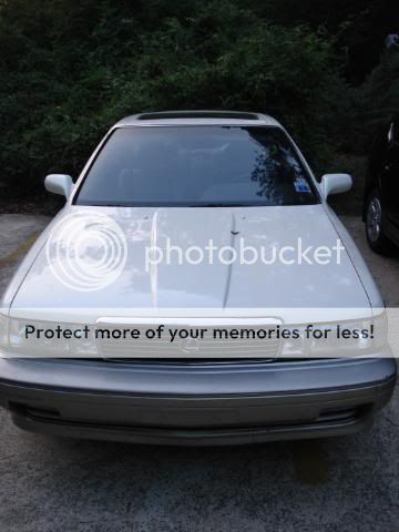

    headlight out- turns out the bumper didn't have to come off. i forgot to take an "after" picture. but the new one is straight.
    note the a/c leak :( fortunately we've got the condenser and lines from the camry that'll just go right on in.

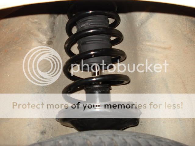

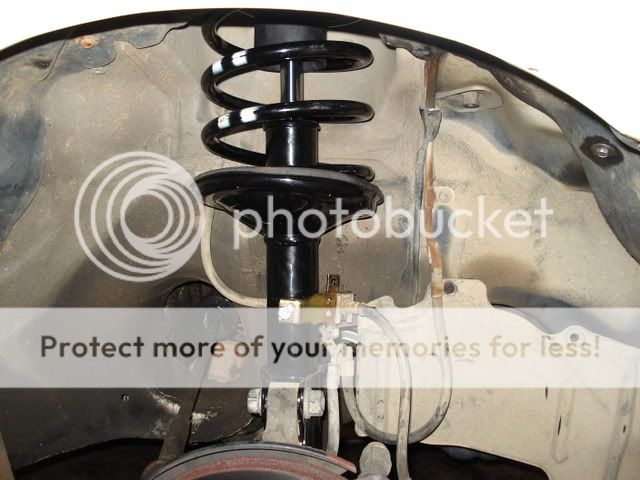

    new front struts and springs and all that. the right side is black, the left side is blue (the ones pictured earlier in the thread.)

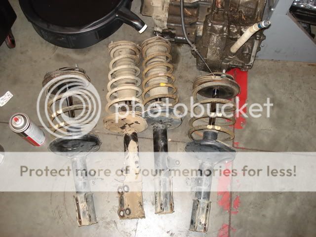

    the old stuff- originals with the car. so almost 170k miles is just a little too long to leave them in...

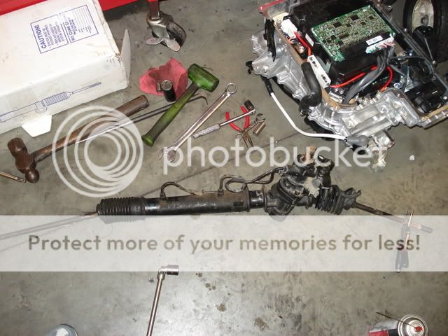

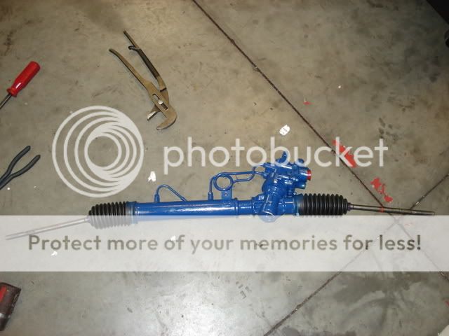

    new rack, another pretty blue
    old rack... ick! and if you're curious what that thing is up on the top right, it's an inverter from a highlander hybrid.

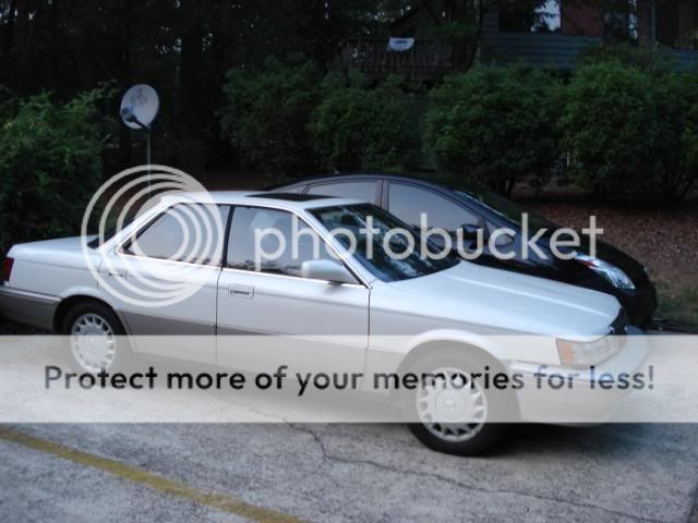

    well, it's official. this car rules! it's been sooo many hours of really hard work (and there are only a couple little things left to do) but we are both 150% satisfied. it's truly amazing, we both agree.
    DH says, "I LOVE MY CAR!!"
    a heartfelt thanks again to everyone who helped us out, i have yet to total it all up but i'm guessing contributions from friends here added up to about 20% of our costs!

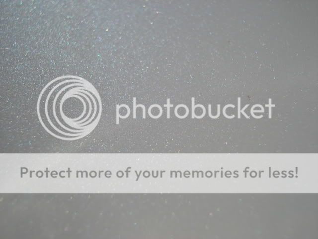

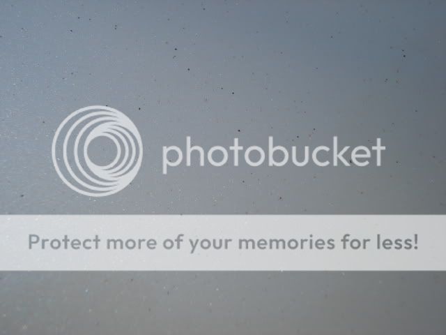

    on to the exterior restoration... washed the car down really well, and now i've spent many hours claying the beast. i'm down to the last panel: the worst one of all, the hood.
    this is what's embedded in the paint. it's really, REALLY in there. so running clay over it till the surface is mostly smooth gets you this:
    then i just keep on until it's silky smooth and looks like this:
