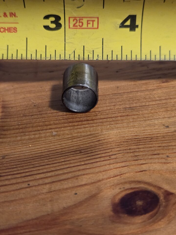

    In the middle of a head gasket replacement and dropped a rocker behind the exhaust. Magnet tool came back with more than the rocker. Any idea where this came from?

    I found one of those in my exhaust, rattling around. Maybe that's something from a sensor

    Looks like a locating tube sometimes they're tapped into heads valve covers to locate the two pieces easily together some form of a spacer a sensor doesn't seem like it would have that at all sensors a lot of times on the end that screws in kind of looks like a spark plug or similar and has a flatter gasket sealing type of thanks similar to a spark plug but not exactly then others that are going in water sensing have o-rings

    That's a guide pin to align the head on the block.
    Looking from the front of the car, there's one on the front right, and one of the left rear.

    That was it, thanks!
