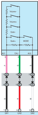

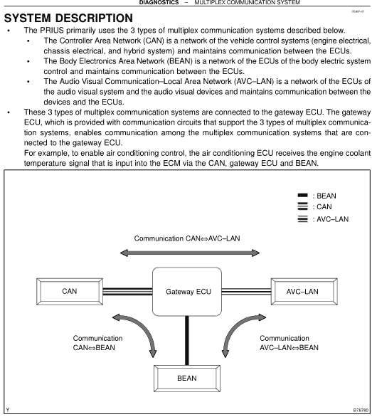

    That's probably not talking about a CAN bus at all. A gen 2 uses multiple network technologies: AVC-LAN, BEAN, and CAN, as you see in this manual excerpt.
    And then there are things that aren't network connections at all. The steering wheel buttons are nothing but an arrangement of pushbuttons and resistors that pull two analog lines down toward ground by different amounts:
    Nothing there but wires straight from the buttons to the radio/player.
    I would call those analog steering wheel controls. Nothing to do with CAN or any other network though.

    Given that the car's steering wheel controls are analog, that would surprise me.
    Unless the Android gadget vendor has mixed up the terminology, or something.
