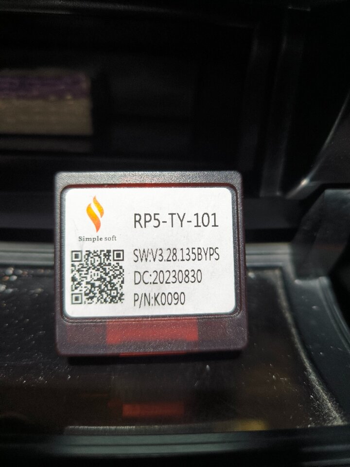

    ohhhh.. you have to change the canbus settings... uhm. I need to find the exact settings through my notes... also, can you post a picture of the sticker on your canbus module?
    you see here.. if not mistaken, this is your problem. i cant wait to get another tablet, these days my notes have been horrible and all without mine.

    what does your canbus box look like? the climate controls are triggered by the snow flake.

    I attachment is .y canbus but im not sure i have the right wiring loom for prius with navigation and jbl system.
    Could use help. :)

    I did try different settings of canbus but seems like its not connected to the canbus box the proper way or i need to use 68ohm resistor on all white pink wires on connector that is not connected to close the canbus circle
