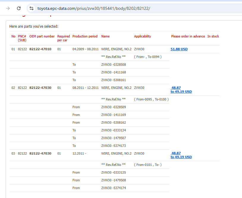

    Good to know. Someone asked about me picking a 82122-47010, since their friend was quoted $600 something dollars for to replace their reported "recommended replacing..." "....chewed through" cable. I found a 82122-47030 that looked the same and the data showed like there wasn't interchange information. However, this table made me think was a similar enough part aligning with everyone's prior observations.
    Any observations where the 82122-47030 cable would not fit in the 2010 AC Compressor design system as a replacement?
