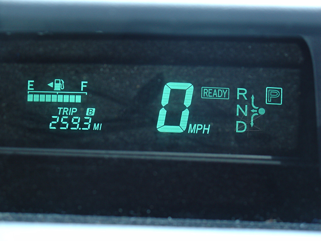

  13. JimboPalmer
    Apr 14, 2009
    12,470
    6,879
    Greenwood MS USA
    It is not an analog gauge that moves, there are 10 lighted marks, they disappear one by one. They are commonly called pips.
    Gen 2 (one pip is gone)
    Prius v (full)
