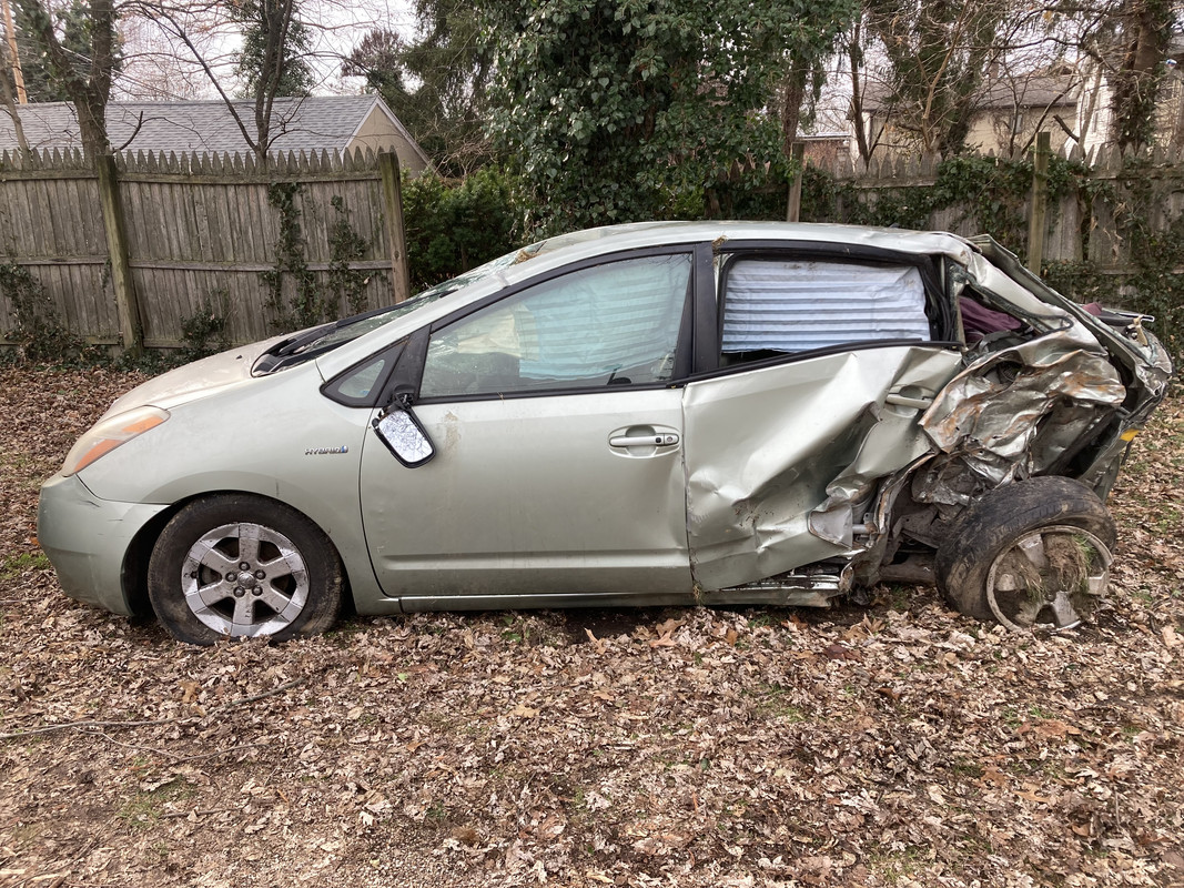

    I have a junker/wrecked parts-gen2Prius in my backyard had around 250K miles before accident. In total I have 3 of them (2 working + the wrecked one). I'd like to get rid of the junker as I'd like to clean up around the house tbh. I made a thread about 2 years ago asking what to pull...everything mentioned by you guys has been pulled (headlights, dash, mainscreen, HV battery, etc.) Currently my dog is always sticking her nose by the car, so I'm pretty sure there is a family of mammals living under there. Moisture has also created a lot of mold in the interior...so that's all trashed too.
    Really only thing left is whatever is under the hood.
    How should I go about doing this? is it even possible without some kind of lift (meaning ...can I take the engine out & apart piece by piece) OR should I hire help and pull the engine out OR should I just get rid of it altogether (Prius engines are relatively cheap). Other than the brake-actuator not sure if its worth the hassle.
    Thoughts?
    EDIT: called salvage yards and if all the valuable parts are pulled they pay by weight (roughly $100 per ton). Gen 2 Prius weight is roughly 2900lbs so at most I'd be getting a few hundred dollars out minus their tow-fee so only a couple of hundred bucks.
