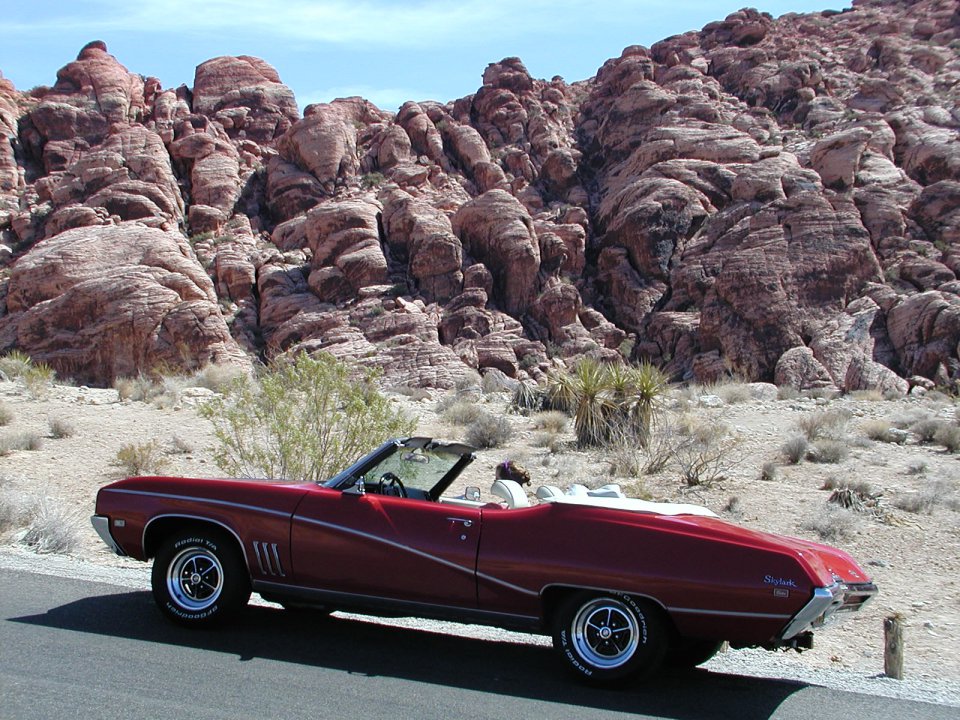

    Our classic Buick Skylark dos not get driven in the winter, and will go weeks in the summer without being driven. So I have always kept the battery hooked up to one of these inexpensive "float chargers":
    Automatic Battery Float Charger
    By keeping the battery on a float charge, the last battery in the Buick lasted 7 years, and it was still working fine, but I no longer trusted it as it was so old, and did not want risking getting stranded somewhere. The "float" actually works to lengthen a less used batteries life!
