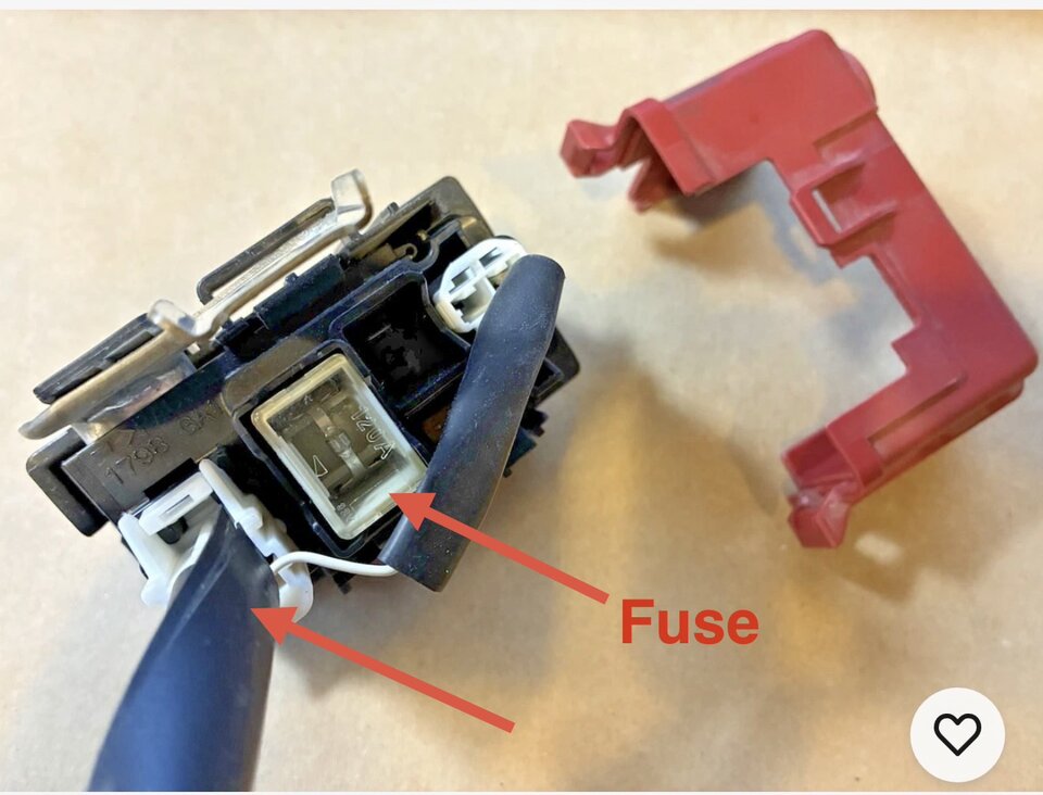

    1. Check that the electrical connections at the battery posts are clean, that the ground strap to the body is good, and that the thick cable from the front of the car is plugged into the gizmo on the positive post.
    2. Make sure all is good with the 12V, battery and wiring wise:
    Test 12V voltage at the battery posts.
    Test 12V voltage at the jump point.
    If everything is good the same 12.x V will be measured at both (plus or minus .01 V or so.) If it isn't something is broken between those two points. A likely culprit would be the fusible link in the gizmo on the positive battery terminal.

    Sounds like no connection at or near the 12v battery. Could be the positive or negative side including the 12v fuse at the battery terminal or the 12v battery ground terminal on the chassis.

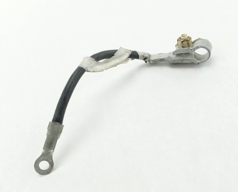

    For the OP, that last picture isn't aspirational. The strap is corroded/dirty at both ends. If yours looks like this, clean the metal before reinstalling.

    Showing him it has a chassis connection that is just as important as the positive terminal or fuse. Yes, I changed my ground cable once.
