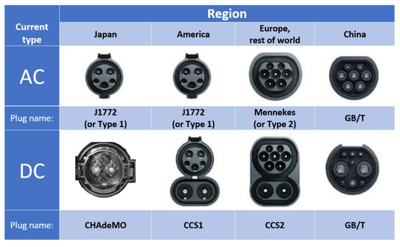

    Great info, thanks for sharing, I noticed on some web site maps of charging stations where some locations have a combined "CHAdeMO + j-1772" connection, does that mean the same plug will fit both or that they have a separate plug for each ?
  12. JimboPalmer
    Apr 14, 2009
    12,470
    6,876
    Greenwood MS USA
    It almost has to be separate cables and plugs.
    I confess to not knowing anything about Mennekes or GB/T
    RichardB, GKL and TGrracie like this.

    GB/T just means 'Chinese standard', kind of like IEC in the US--the 20234 is the actual standard number for the connector. Though outside China people just call the connector GB/T. It is used throughout China. The Teslas sold in China have this connector.
    There's a new connector that China and Japan are working on together that is a superset of CHAdeMO and GB/T20234 that can go to 900kW.

    Thanks, it also seems to me they'd need to be separate, maybe it's just how it's listed that makes it confusing. Since I'm still waiting on delivery of our Prime I have yet to look at any charging station in person yet since none are within 10 miles of where we live.
    Here is a partial screen shot of one of the online charger info that makes it confusing -
  15. Jon Bloom
    Jon Bloom Member
    Feb 1, 2020
    77
    78
    Connecticut
    So that station has CHAdeMO and "J1772 Combo" connectors, but apparently no plain J1772. I believe what they are referring to as J1772 Combo is the CCS1 connector in the above picture; it's an extension of J1772 that adds fast DC charging and is not compatible with the Prime.
