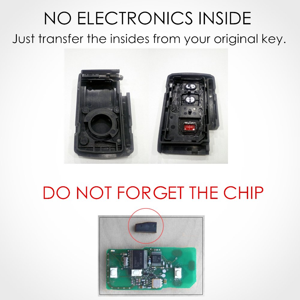

    I've just run into this myself with a gen 2 where the seller provided me two fobs, and I neglected to verify they both worked, silly me.
    It turns out there are two different bits of technology tucked away inside the fob. In this picture, one is the green typical circuit-board looking thing, and the other is the little separate black chip (shown circled):
    Likewise, you can find two different sets of utilities within Techstream for registering the fob to the car. One is found under the "Immobilizer" ECU, and the other under the "Smart Key" ECU.
    The "immobilizer" registration only cares about the little black transponder chip, and it only affects whether the fob will work for starting the car when inserted in the dash slot. That little chip just has a fixed ID number and never changes, and nothing cares if it has been registered to another car or not. You can always use the immobilizer utilities to at least register that chip ID, and the fob will be usable to start the car, when inserted in the dash. Registration just remembers the chip ID in the ECU in the car. Nothing changes in the chip.
    The "smart key" registration deals with the other part of the fob, the remote radio transponder electronics, and that's the part you need before the fob will open the doors (either by proximity, or by pressing the buttons), or before you can use it to start the car just by proximity (not inserted in the dash). The "smart key" registration process does a two-way radio handshake with the fob. After registration, the ECU memory in the car has stored information about the fob, and a memory in the fob has stored a vehicle ID for the car. After that, the fob will not respond to any future registration attempt from a different car. So if you get a used fob that has some other car's vehicle ID in its memory, you won't be able to complete smart key registration with it. You'll see the fob LED blink at the crucial step, but Techstream will act like no response ever came.
    The solution is to buy used fobs that have been "re-virginized" (had any previous vehicle ID cleared out of their memory). You can find sellers on eBay, etc., that offer them that way.
    Or, if you are stuck with a used fob that wasn't re-virginized already, you can find services that will just do that, so you'll be able to register the fob you have. I haven't used any of these services yet, but obviously, I am now in the market. The ones that pop up on eBay seem to charge $15 to $19 or so, and this site seems to be about half that. (Caveat: I haven't contacted any of these sites yet to see if the Gen 2 Prius fob is one they can actually do.)
    I think that lower-priced site really operates on the model that you send your fob, they clear it and send it back. Some of the others look like they might just send you an already-cleared one and expect you to return your uncleared one as a core. The difference could matter if you're in a hurry.
    Just clearing the used fobs seems like a lower-impact solution than wholesale reseeding the car's ECU, which would seem to me more like a last resort.
    -Chap
