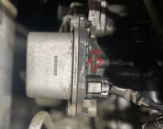

    Are you quite certain you found the engine water pump? In the less-blurry photo, that connector looks so much like it, I would be hard pressed to think it was anything else.
    Can you give the wire colors brought to that plug?
  6. Micah Wullschleger
    Micah Wullschleger New Member
    Jun 11, 2023
    Tijuana
    Here it is I believe.
  7. ChapmanF
    28,543
    18,884
    So, the loose connector that isn't identified yet. Wire colors?
