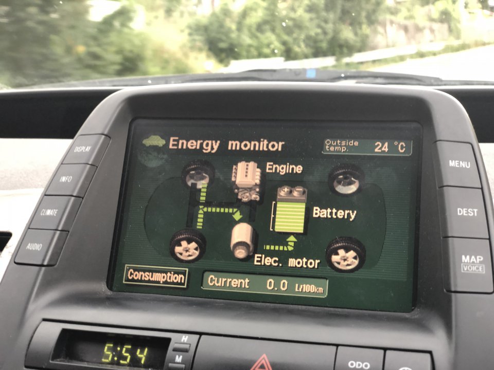

    Can you damage the battery by overcharging them? Or where doses the charge go if all the bars are green, don’t want to damage the battery

    That doesn’t actually mean the battery is full;).
    It’s probably more like 80-85%:).
    The Toyota battery management system ensures the battery is protected (y).

    the engine will spin to burn off excess charge.

    How fast does your battery charge and then drain?
    If it cycles between full and low on your screen, your battery is showing early signs of failure.

    If you let the car's own programming control the battery charging, no.
    If you're into cleverly defeating it, yes.
