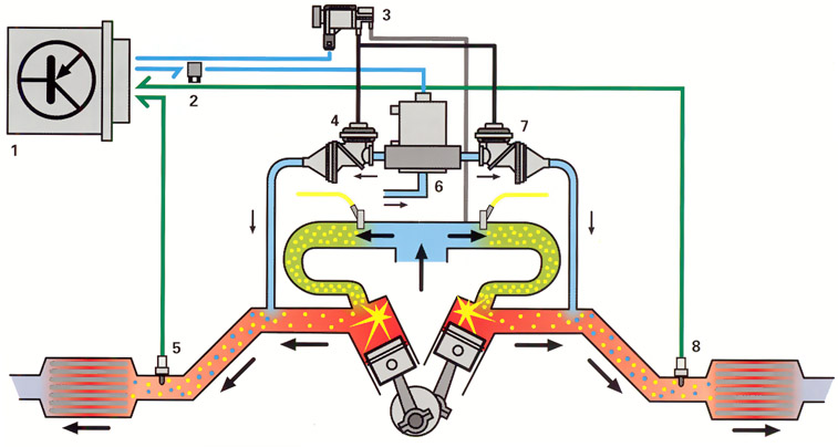

    That is not all all what was done to clean up the Volt's emissions. Its not pumping in air to "dilute", its pumping in oxygen to support the catalytic conversion process.
    The secondary air inject process ly its drawing in air to inject air into the catalytic converter which uses the added oxygen to improve the conversion during the cold start. The image below (from 12v.org) can help explain the process.
    The basic concept of a secondary air injector is that an engine requires a relatively rich mixture for smooth operation on cold start, but the oxygen sensors (5,8) between the engine and the catalytic converter don't operate well at cold temps (< 500C or so) so cannot control the fuel mixing well enough. For this reason, the engine control unit operates in more of an open loop mode until the system and the oxygen sensors have heated to operating temp, which takes the the first 30 to 90 seconds of engine operation . Because of this, exhaust gases contain high levels of carbon monoxide and hydrocarbons after cold starts.
    The unburned hydrocarbons could be further oxidized, except there is no oxygen left after combustion. By adding the secondary air injector they are feeding air (i.e. adding oxygen) into the exhaust manifold, so the CO and HC are oxidized through after burning form water and carbon dioxide. The exothermal reaction also increases the exhaust gas temperature, which warms the catalyst more quickly. To achieve efficient warmup operation, a high secondary air flow rate must be achieved within the first few seconds of engine startup, and the air flow rate must be maintained until oxygen sensor control is in operation. Air flow is maintained by an electric air pump (6). Once the oxygen sensors and catalytic converters have reached their operating temperatures, valves (4, 7) cut off the secondary air flow. In less the 2 min the system is at operating temperature and the secondary air injector turns off.
    Secondary air injectors are used on a range of vehicles, including multiple Toyota models.
