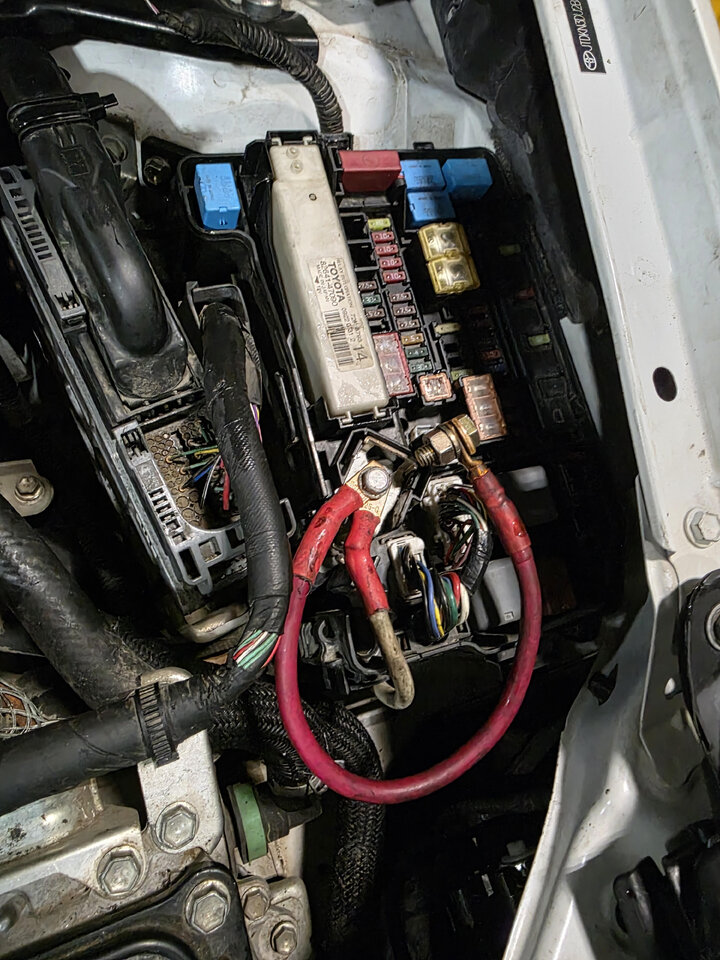

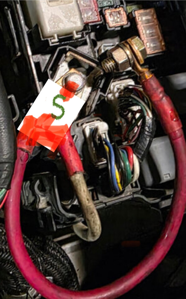

    How did you bypass the 125a? Can you post a pic?

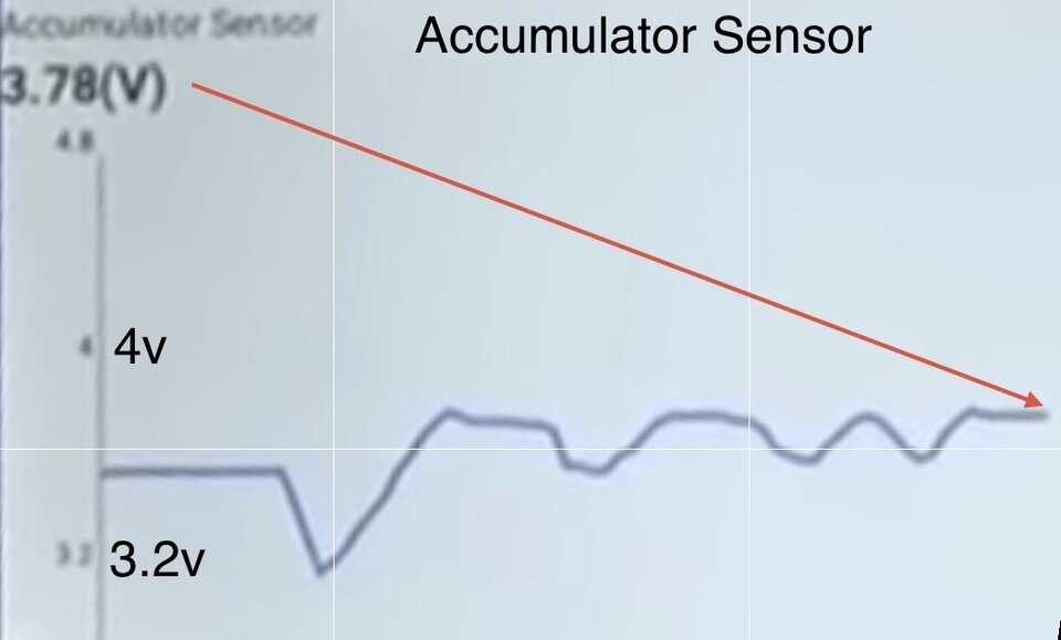

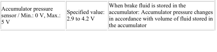

    That certainly is not right. There is an "Accumulator Sensor" (accumulator pressure represented in volts) you can graph.
    Based on the attached replacement video, that sensor should start the pump around 3.1v and stop it around 3.8v. One of your techstream screenshots shows it at 3.58v.
    It might help isolate the problem if you know what your pressures are doing.
    Accumulator Sensor 3.1v - 3.8v
    Initial startup after bleeding. Each brake depression causes about 2 seconds of runtime after the first cycle.
    The repair manual pdf on the Accumulator Sensor shows a range under certain conditions of 2.9v-4.2v
    This video fairly comprehensively documents the replacement bleeding and calibrations.

    It looks like the pump is giving you good pressure but it is not dropping hardly at all on brake activation compared to the graph of a known good in the post above.

    It looks like your 125a bypass has no fuse. I think I would add one at some point that functionally separates the white 12v incoming from the inverter connection.
    However the lack of a 125a fuse is not the issue with the brake booster.
