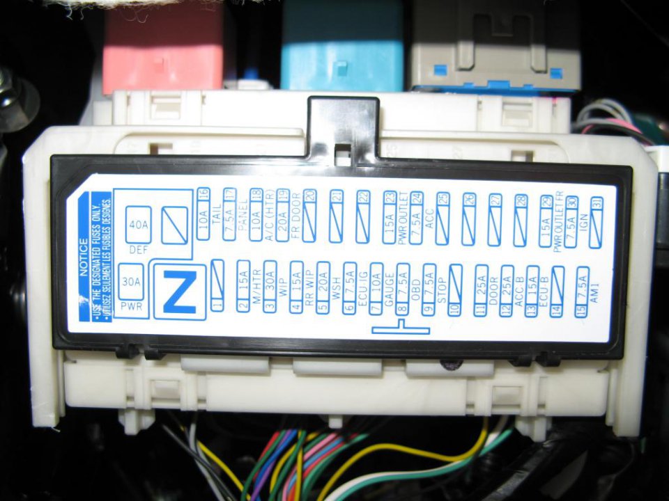

    I am trying to locate the 30 Amp fuse for the Power Windows and the 40 Amp fuse for the Rear Window Defroster.
    The manual shows it to be in the fuse panel inside the cabin. The cover on the panel shows it to be there.
    However, when you remove the panel, the two fuses are not there.
    With that said, does anyone on this board know where those two fuses actually are?

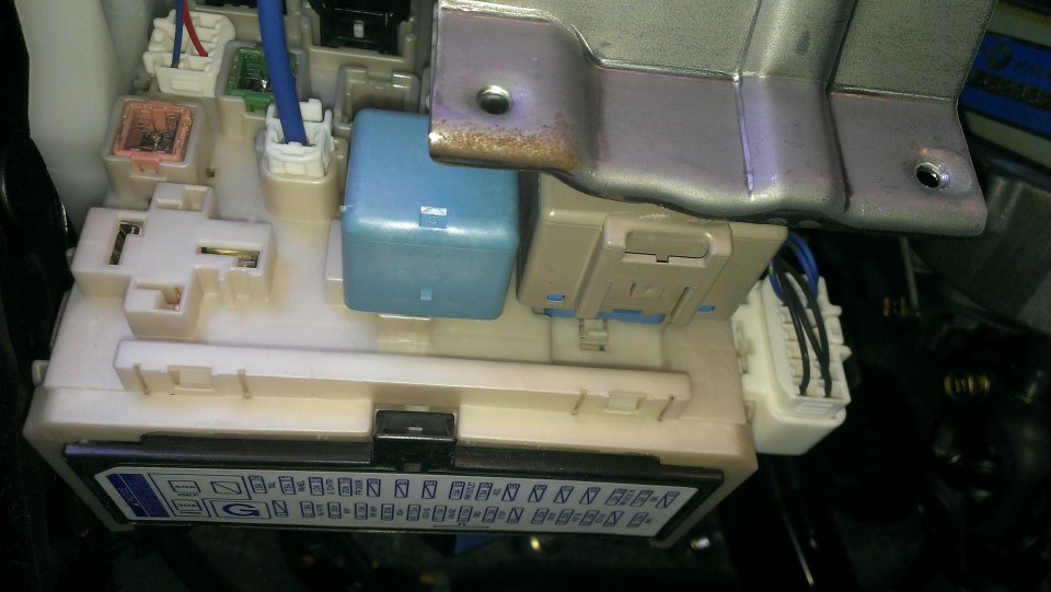

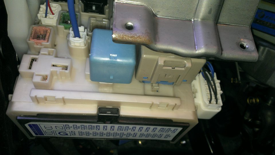

    Look at the upper left of this picture.
    Avi
    HeadOfJarg, Braveslice and dorunron like this.

    Thank you for that, is there a easy way to access that without having to remove the dash panels? I keep wondering if the panel is hinged or something like that.

    All you need to do is pull out the left A/C vent and remove two screws. One screw will be exposed once you remove the vent and the other is right above the hood latch. After you get that done, pull the panel towards you while holding the upper (black and above the steering column) panel back.

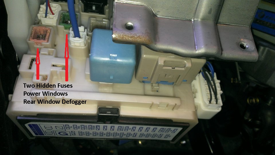

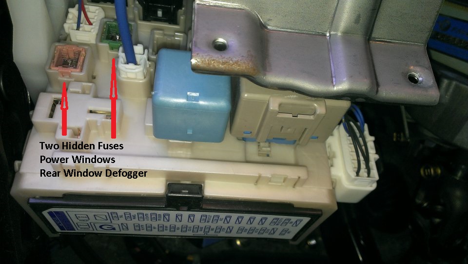

    I believe it is one of the two fuses pointed out below in the picture.

    Thanks Dorunron, yes its the green one, but I still had to unbolt that metal plate to be able to get pliers on the fuse but its out now and it was the fuse that was the problem.

    Avi is the one to thank. He posted the pic and told me where to look. I then took his pic and marked the areas where the two fuses are.
    I wanted to know because I could not find them either after taking the cover off trying to help other's here on PC.

    Do you guys know now where the DEF relay is located? Is it that blue box in a picture from dorunron?
