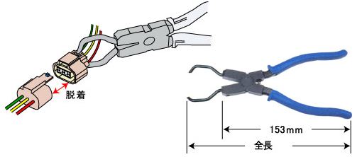

    I don't have one of these, but there have definitely been times I would have cussed less if I'd had one.
    AMTilts and Tombukt2 like this.

    I have those for the washer spring for the appliance I hadn't seen them for this type of plug I'll have to look into that that would be very handy and imagine they're not very expensive
  6. Mendel Leisk
    61,375
    42,237
    Search for "disconnect pliers" gets good results.

    Thanks for the suggestions. I was finally able to get them off, using Mendel's advice of prying at the base while pressing really hard on the tab. I used a bent pick to pry, and pressed the tab with a pair of wire strippers that were shaped somewhat similar to the tool ChapmanF posted. I still ended up having to press VERY hard on the wire strippers to get it to unlatch. Took about another 1 1/2 hours on Sunday just to disconnect it and the other one that was giving me trouble.
